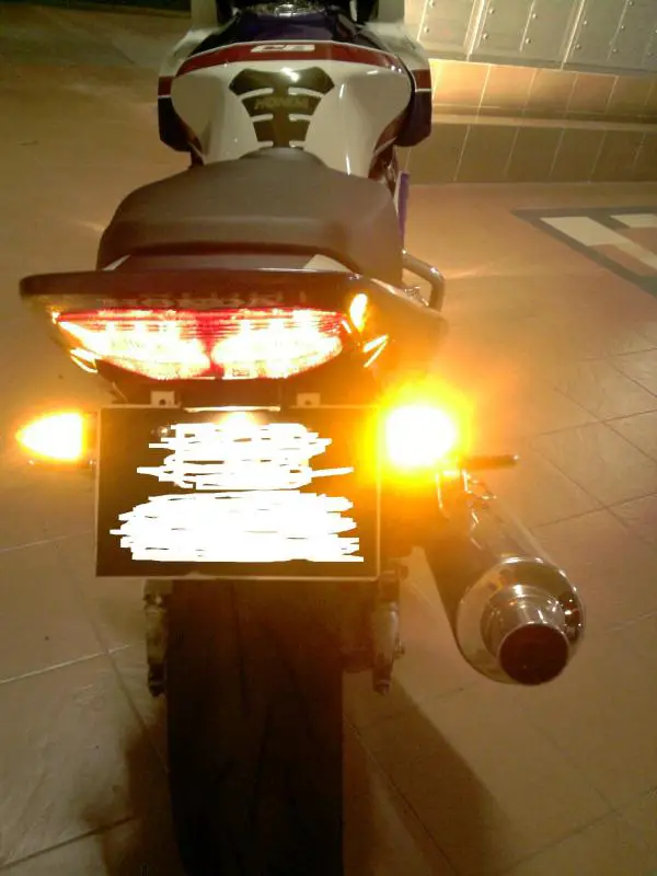

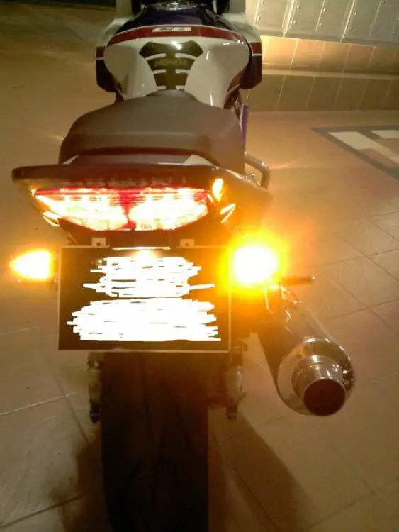

Which flush indicators you using? Was thinking of changing mine too... Flash rate remain the same?
Should be the same Fazli, if different also can change the setting right? :angel:
http://i648.photobucket.com/albums/uu205/ainyan090407/LVInfernalWar.jpg
http://i648.photobucket.com/albums/uu205/ainyan090407/3583_photo.jpg
i using YC trading flush indicators =)not same haha its blinking at a faster rate =)
hahaha cos most relay for signal based on the total impedence of the signal system to determine the blinking rate...leds have smaller impedence thus will blink faster as compared to stock:cheeky:
can purchase a pair of solid state impedenceis to slow down the blinking rate but i think blink fast fast good eh HAHA

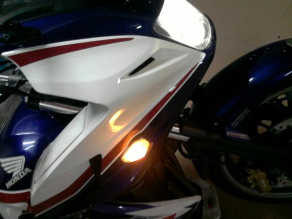

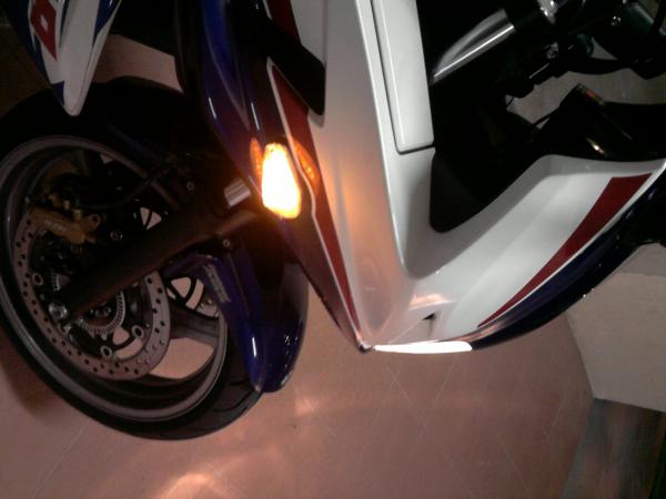

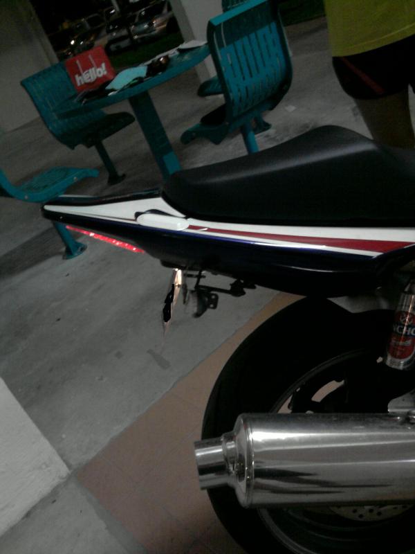

[ATTACH]152875[/ATTACH]
[ATTACH]152876[/ATTACH]
its the arrow led signal lights folk haha,did both the flush led signal and arrow led signal yesterday night =)
the other pic is the side view of my fender eliminator =)
Very bright i like it.. can feel the poison already.. lolz
