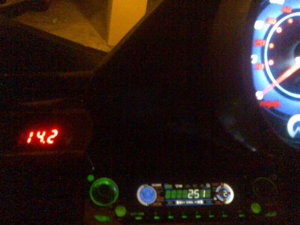

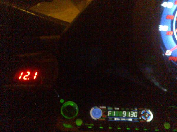

Hi Paiseh
Yes the digital voltmeter does shown 12.1 volts when turn on the ignition key and when the scooter got started the voltmeter showing 14.2 volts.
I only got to know that the Advia 200 is equipped with the type 14 volts just about 2 weeks ago.
As my bike was fitted with a direct radiator fan which I manually turn on as often the temperature gauge shown close to the 100 degress level that I switched on to cool the radiator have then forgotten to switch off after reaching my destination.
The battery was drained completely flat with the fan running for more than 4 hours of parking. Had the drained battery dismantled to a bike shop to have it charge. At Future Scootering shop is where the mechanic informed me that the battery is a type 14 volts and required about 2 hours of charging time to achieve full charge.
The shop loan me a 12 volts battery which I went back to my bike, fixed up the loan battery and got it started to ride to the shop. During the wait at Future Scootering is where ended up to have my both tyres change to the Michelin City model tyres.
Maybe will end up changing the drive belt in Future Scootering or AS Poon shop at $160 if there remain no news to buy the belts. Intent to buy and have it change in JB as recommended by Deriyu.
Really confused as enquire with Ma Pte and was informed to have the drive belt replacement carry out when the mileage at 15K km and another shop reply was to have it change only at 25K km.
Btw had attached the pics showing the 12.1 volts when ingition key turn on and 14.2 volts when the scooter had started up.

Hi Paiseh

I do have a switch to on the fan manually. But, its not connected! Mah salesman told me the previous Adiva 150 had this switch as it was air cooled.
the new adiva200 has a radiator and hence the switch is not 'used' but still brought over from previous model.
when i turn ignition on, voltmeter shows 12.2V. when i start my bike, the max i have achieved is 13.6V when all lights are off, except for the meter lights.
when is your adiva200 manufactured? mine in 2008. but registered this yr. and its fitted with a 12V battery. duno wat the diff?

My Advia AD200 is register in 13th July 2009 and I only collected in on the eve of National Day 8th August 2009.
The handle bar right hand switch is not connected to the radiator fan as the fan suppose to start automatically when the temperature gauge is reaching the red line.
In the first 3 months, the temperature meter easily reaches the red line or pass the 100 degress very quickly and the fan seem not auto start to cool the radiator.
When back to Ma Pte and they separately install a cable to a switch hidden in the right glove compartment and told me to switch if the temperature gauge is in the red zone. This connection is the direct link to switch the fan on.

Mine is confirmed a 14 volts battery and yours is the 12 volts type which do not know why is the difference?
