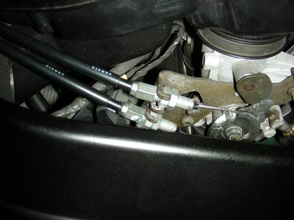

i cant find the damn idle valve!!! hahaha! ive read its on the left side of the bike between the frame and the tank
This is what i found online..
Is it the gold screw on the extreme RHS of the pic with the exposed thread?
If thats what it is, i dont think i can reach it without removing the tank right?

And isnt adjusting the idle not completely solving the problem?
As in, it is simply a 'mask-over' measure if it is lets say, a TPS issue?
Actually that's not what I meant. Increase the idle first so that you don't flame out while riding, which I think is dangerous. Then ride more to clear old petrol and carbon built-up. Then only adjust back idle and check if problem solved. Don't need to lift tank but need to wear gloves.
