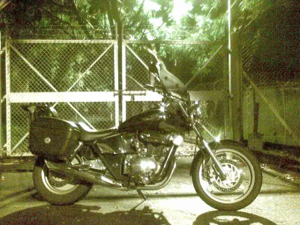

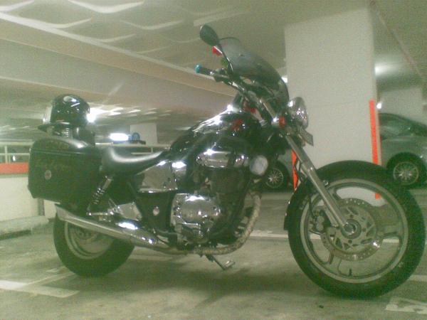

There are two shops at Geylang that does electroplating. Yes, only two shops and they are next to each other.
I sent many parts from my Phantom there for chroming at a price of $400, this includes both front forks, triple clamp, risers, front console, rear footrest mounts, both halves of the engine crankcase aluminum covers.
I was waiting for my scrapyard thai chopper to be rebuilt anyway, so it was money well spent :D
PM and I'll find the contacts for you. You can also visit one of my trusted mechanic's shop to act as an agent for sending and receiving parts (shop will get a quotation for you) but bear in mind it takes some amount of time (1-2 weeks) for the process to be finished as there is quite a bit of preparation. You will also not get Harley-style architectural-standard double/triple chrome (which is fantastic to touch and ultra-durable) as we don't have the technology for that locally.
But chrome is so much better than unpolished rice cooker aluminum :D
