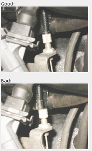

During rides when I'm slowing down at junctions and during traffic stops, I can see my rpm sometimes idle below 1000, nearing to stalling. It even died once when I throttle off when I was coming to a stop.
Fuel injectors dirty? Anyone knows a Beemer mechanic (besides PML) who can tune or clean the FI injectors (or whatever causes this issue)?
kobane...could be many things causing your problem.
Be methodical in order of cost and by work involved (lower first of course). I also assume that you don't have any power commander or fancy accessories. Please don't hold me liable as speaking from my experiences (painful ones) and just trying to help.
Side stand and Clutch engaged CUT OFF switch must be working i.e. must not be in 'CUT OFF' position, even if intermittent.
1. Check throttle cables. Sometimes, the cable housing does not sit well in the cable end screw adjusters. Results in rough idling.
A throttle body sync is really not necessary unless you are have really eliminated all other issues (see pic).
Syncing a throttle body is a complex exercise and you should never touch those brass screws unless you're experienced enough.
2. Check spark plugs and replace if need (of course, who don't know this).
3. Water in the Tank? (when bike is on sidestand, the water will flow down to the left whereby the fuel pick up is on the right. Things will be fine for a while until upright or you lean to the right).
3. If you have to remove the tank and undo all those bolts to get to the fuel filter, you might as well change the fuel pump and the U-tube (sometimes crack and leak at age...like people), especially if you have done over 50K since you or the previous owner last did.
http://www.euromotoelectrics.com/BMW-R-K-VDO-Repl-Fuel-Pump-16-14-1-341-231-p/fp-231kitplus.htm
If its a fuel pump problem, you usually experience the bike unwilling to pull at high revs.
4. The most painful (to your wallet) but yet, the most likely after hearing your brief description.
