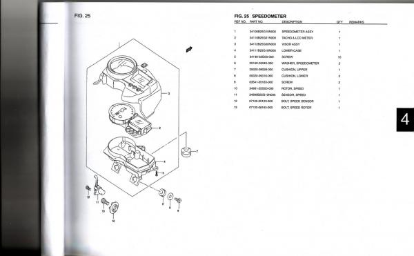

Just discovered a new prob with my bike..... the speedometer is giving inaccurrate speed reading! I've been wondering why i seem to be cruising quite fast but the speedo reads only 50-60km/hr.
Today i finally had a chance to find out. I cruise along a Honda Civic (has digital speedo too & easily to read from my bike) at TPE and guess what...
My speedo says about 70km/hr.... The Civic's speedo says 107km/hr!!!
Now i finally know why my Raider's top speed (Tried once on a straight road) reads about 105km/hr no matter hard how i tried.
Anyone know if the speedo meter works by cable or some Solonoid? I'm gonna try to open up the speedo area and learn more.

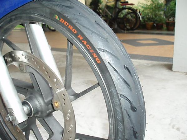

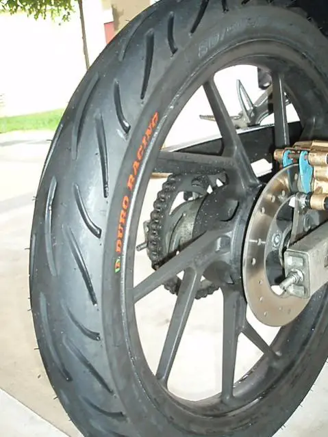

Duro RS Front $45
Duro RS rear $50
Tyre pressure
Front 30psi
Rear 45psi - my style
Tyres manufactured September 2009

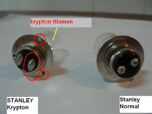

7 June 2010
Meter 42143
Upper East Coast Rd

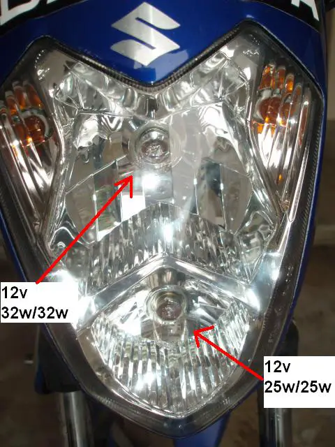

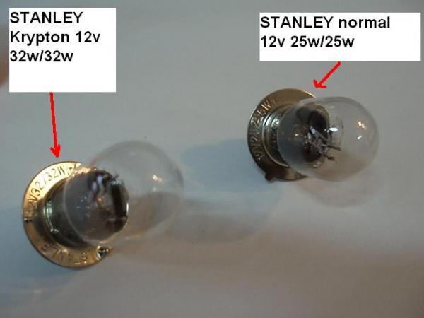

Stanley Krypton Bulb 12v 32w/32w $5 - 1st bulb
(for spare) same bulb $5
2nd bulb 12v 25w/25w normal Stanley from JB

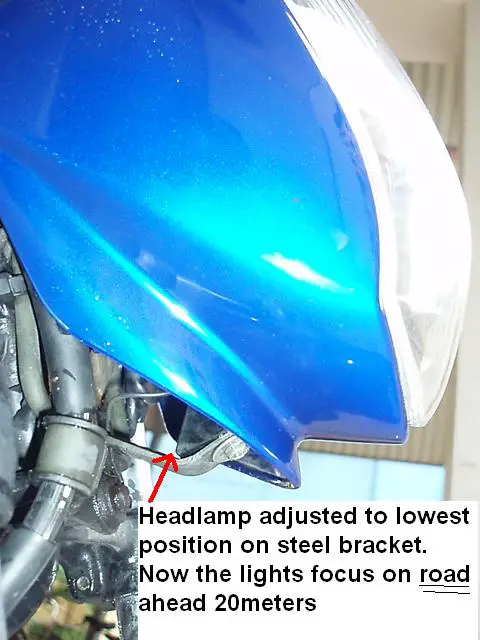

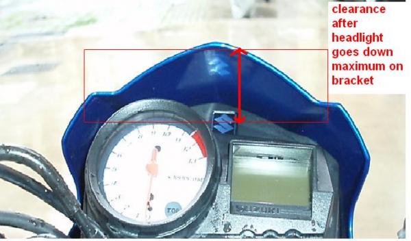

Headlamp adjusted to lowest position on steel bracket

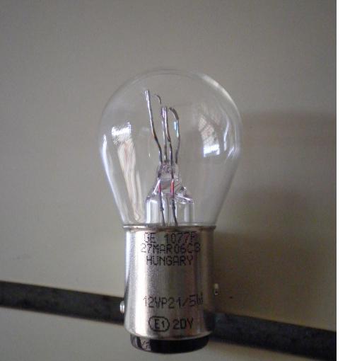

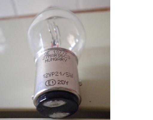

REAR bulb
u may use 12v /21 /5w instead of 12v/18/5w
see the bulb has bigger solder and made in hungary

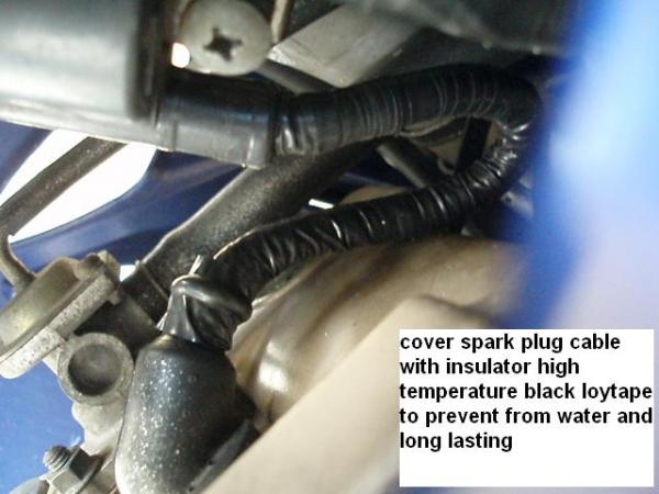

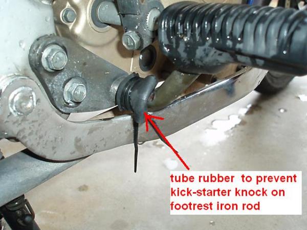

1. changed spark plug
2. changed tube rubber and cable tight for kick starter from knocking foot rod.
3. sealed with black loytape insulator for spark coil cable

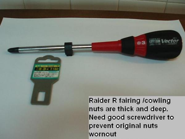

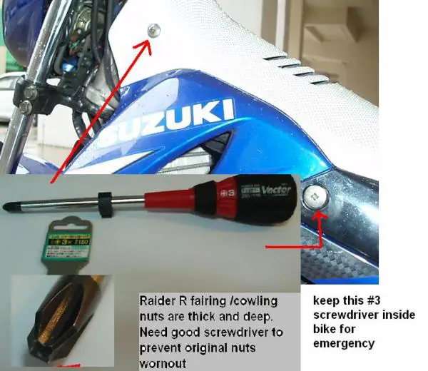

7 June 2010
Sin Hardware, Jalan Besar
Vessel Vector #3 screwdriver $15
for thick fairing nuts

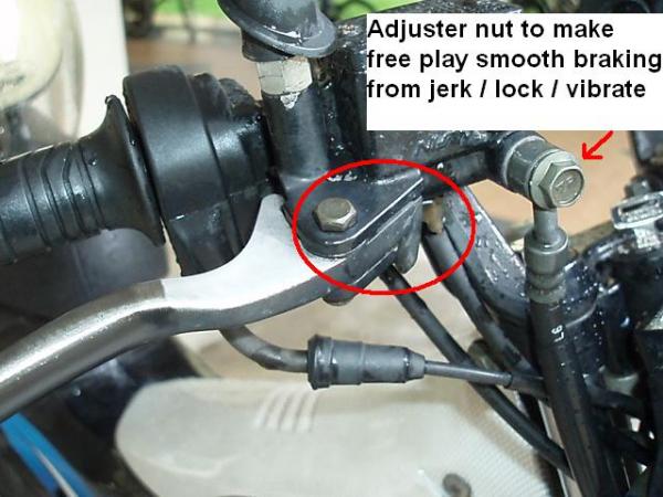

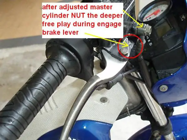

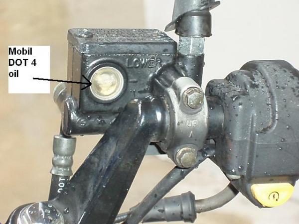

Mobil Brake fluid DOT 4 Nov 2009 bottled - $9.80
Changed both master disc brake pump oil - Labour $5
Re-adjusted front master cylinder pump nut to have more free play smooth braking so that the disc will not lock/jerk/vibrate.

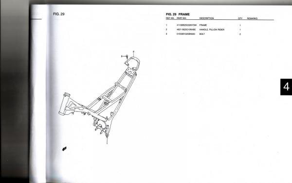

dragster,
rear handle for grip - buy from direct Suzuki SC in JB . Belang R handle more sleek and slim , better then Raider.
suzuki uses ENKEI sport rim made in japan
suzuki using sensor NOT tyre cable for speedo. Look at your front sprocket. There is the black wire connector. If the wrong ratio sprocket size used then the reading will alter.
Edited by gunshead

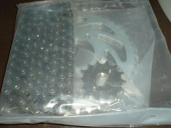

For the sprocket, what is the original size/ratio? I'm not sure if mine is original or changed. Does your speedo reading keeps fluctuating (e.g. 40 - 51 - 43 - 49) even when you are traveling at about constant speed? mine does & dunno if its due to the faulty sensor.

dragster,
front = 14
rear = 43
I buy original factory made for suzuki belang R from Penang. The factory send to Skudai, JB and I collect from there.
RM75 original hard steel 2x sprocket with RKM made in japan chain
You can do the same too.
contact Mr. Andy Lee from
http://www.kilangrantai.com

dragster,
see the attachment
for speedometer , maybe remove the sensor and clean and regrease back
also the handle bar rear pillion
must be purchased from suzuki SC in JB
the design belang is more sleek and sharp.

Tks, i'll get the CD from you first before i open the highlight unit. Tks for the link. I noted that there are 2 workshops in JB designated as the official suzuki parts supplier. Will check it out there.
