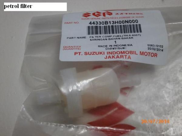

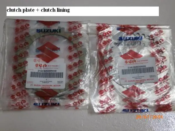

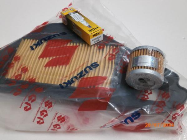

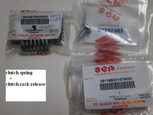

air filter
petrol filter -suzuki genuine . Good compression
ngk g-power
shell R4 engine oil 1100ml + oil filter (new design)

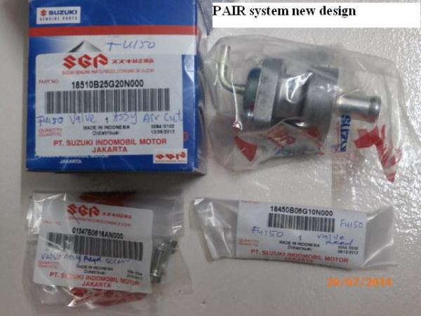

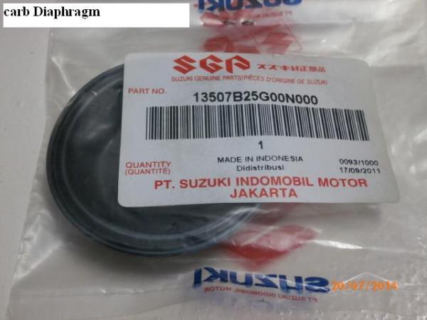

carb diaphgram

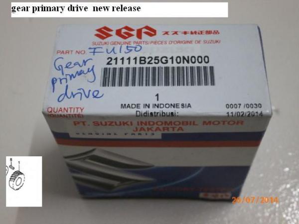

2nd valve PAIR ONE SET with nut (new design).

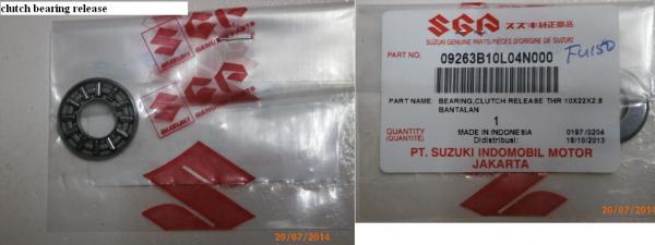

Clutch plate + clutch spring + bolt (new design) + gear driven (new design) + bearing (new design) + gasket clutch cover
4 new nuts body covershield

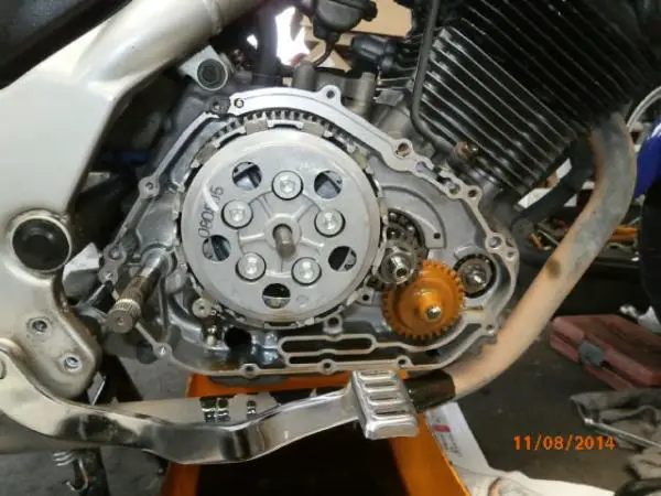

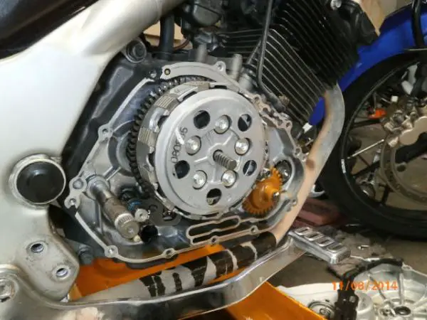

findings:-
first time opening clutch cover since factory . 8 yrs old bike with 97324km
Clutch area very clean - thanks to shell R3 & R4
Default factory clutch plates and lining in superb condition . Only worn out 60%. Thanks to shell R3 & R4
NGK G-power after 9200km usage, shows very plug clean surface and engine Combustion chamber very clean. Thanks to Caltex techron.
After change PAIR (new design) and carburator diaphrgam , RPM dropped to 1300RPM and super stable.

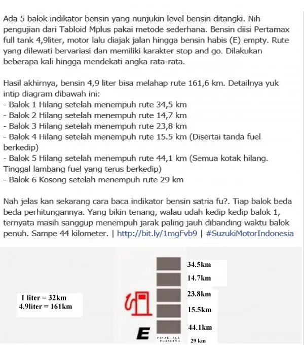

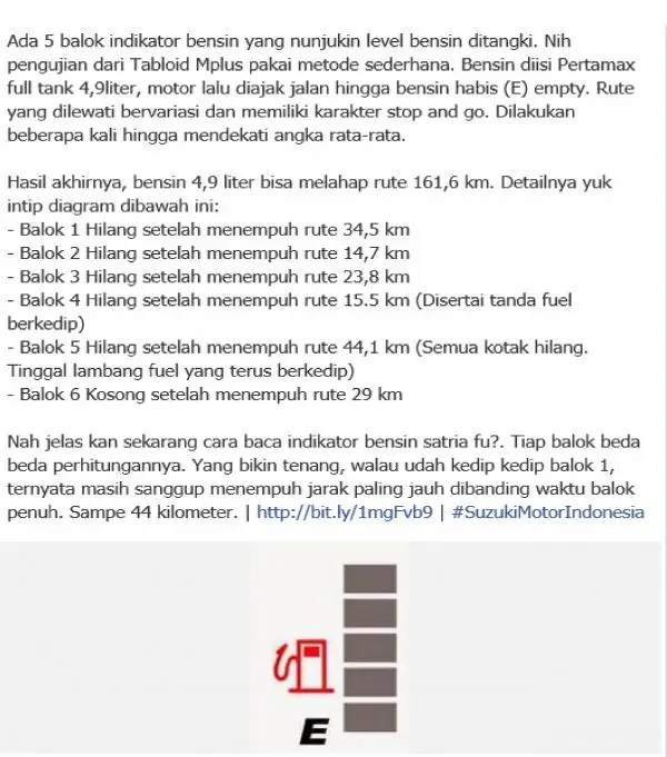

raider r fuel meter reading block by block
also see most below I have another picture with per block mileage side by side

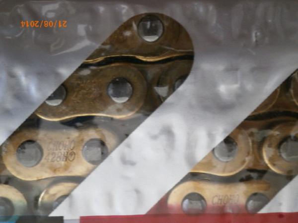

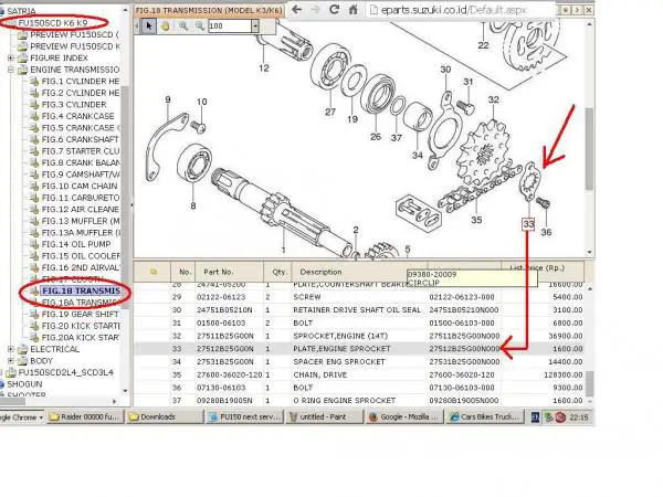

By the way, how is your shinob sprocket set? Is it much better than those standard sprocket sets in the market?
7seater,
DO this
go to Tampoi
Kang Soon accesory spare part shop, tampoi, taman dato penggara barat
very easy to ding in map
it is along skudai highway only at main road can see uphill
ASk for

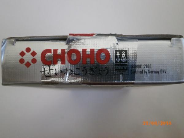

STT sprocket super hardened steel front and rear sprocket
O-ring CHOHO chain 428 120L RM75
buy these 3 items and bring to your shop and fix
BUT LET U KNOW
u must get back the original pin for front sprocket cause front sprocket holes and pin matches only for raider R. I believe previous users modified the front sprocket and pin to yamaha RXZ type. so watch out
otherwise when u buy at Kang Soon ask for front sprocket STT for yamaha rxz.
Also to know the parts visit http://eparts.suzuki.co.id/

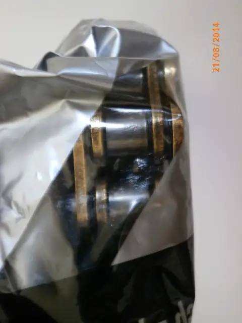

to all raiders
use o-ring as chain drive
do not use normal 428 or 428 heavy duty
this bike is 120link long and very fast slack loose. it is wasting time always to go thighten
this also casues power ratio drop cause chain loose
must use o-ring chain
cheapest o-ring i use is CHOHO o-ring made in china but it has highest quality and japan spec and certified by norway standard
RM75

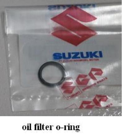

meter
97966km
changed engine oil
shell R4 1100ml pour until middle line through inspection window
changed oil filter
changed oil filter O-RING

ever tried with last bar 1st blink. Ride on from Chinatown havelock CTE all the way to yishun st23 then back to jurong. Finally, in KJE, chua chu kang, start to blink double. Not sure how many km as my odometer already stop at max. Looks quite far for the last bar blinking usage.
