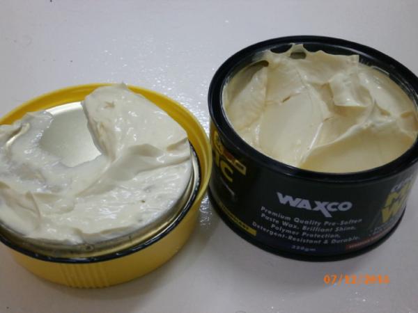

wash and wax using waxco mettalic
wash RM7
wax labour RM10
tip RM3

Hi Gun, so far you use the Waxco is is good? In terms of shine, lasting and ease of application? Good in removing stain on paint?
use that particular waxco wax metallic . must be the same I used. it is superb

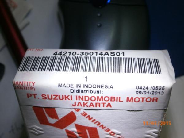

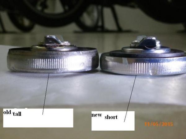

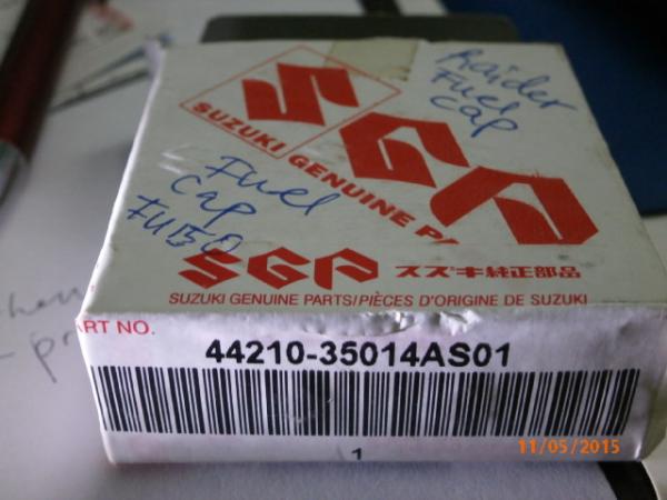

11 may 2015
meter = 05703km

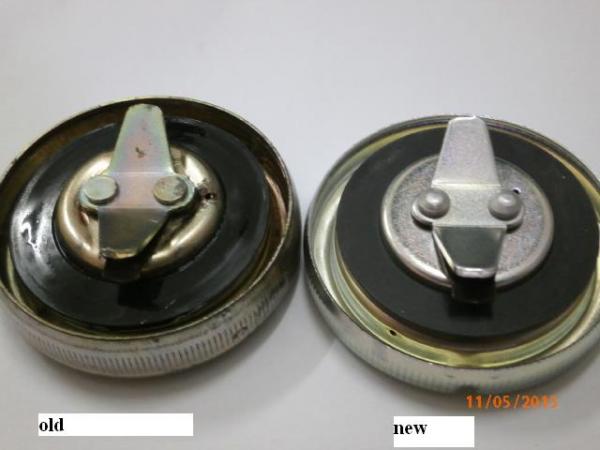

changed the fuel lid cap
cause suspect after full petrol tank the rubber is not strong and leakage around tank
changed to new corrective action part number

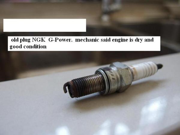

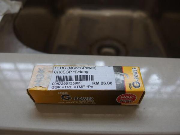

changed
air filter yellow color
ngk G-Power

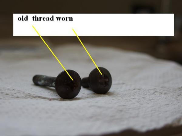

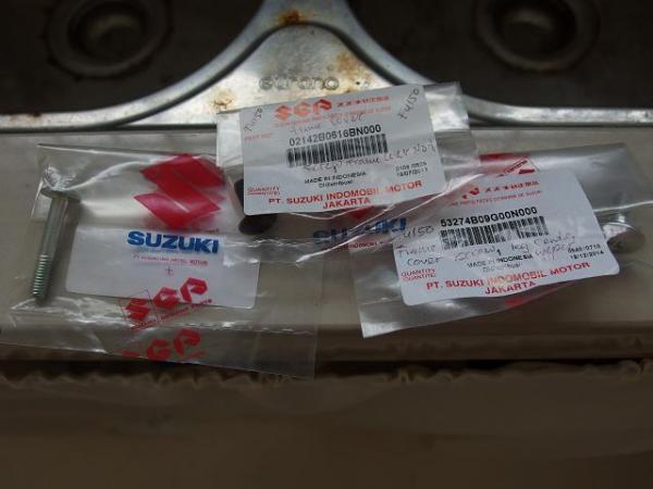

many screws of body cover frame changed to new one cause one one thread worn out. Used all genuine suzuki screws.

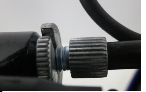

Tighten adjuster clutch cable lever

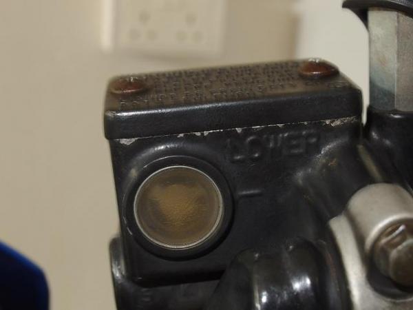

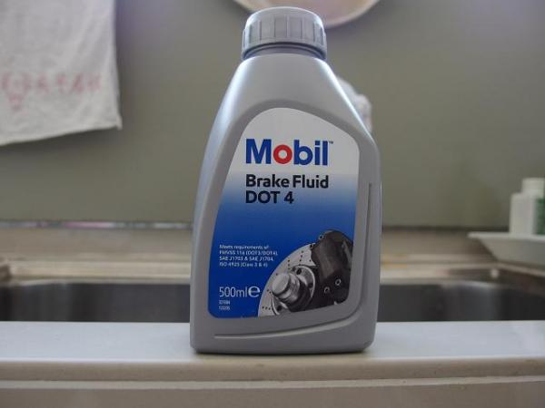

Brake fluid Mobil DOT 4

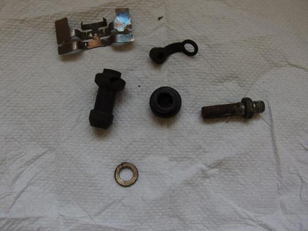

Overhaul front disc caliper . changed many corroded components. Apply red grease
