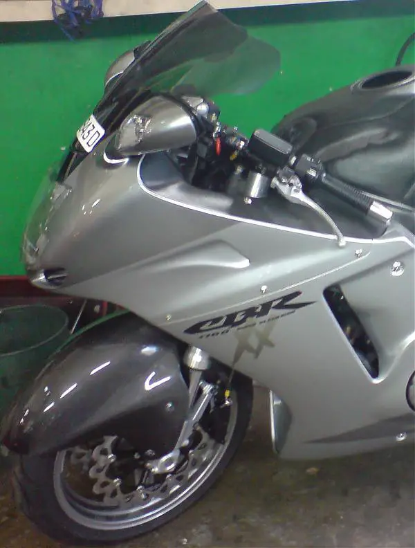

My bike is almost complete. Only small adjustments like ERP Unit bracket, placement of hazard light switch and of course (one of the better reason for having the front fork) the settings allowed to the dampening and rebound of the front end.
Notice the faint 2-tone paint work copied from 2007 BB models. :thumb:
bro really envy ur mods man hahahaha i cnt do tht much just wanna change the springs to ohlins which come with the rear set as well.......its ok bro bout the galfer disc good items sure to be snap up very fast.....
Sorry to dissappoint penyu, wish i have another set of disc for you.
