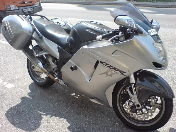

This was my bike when i 1st acquired it early feb 07 (In Silver and stock bike), and now todate, my updated version (In 2-tone Silver and a little modified).
