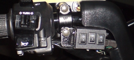

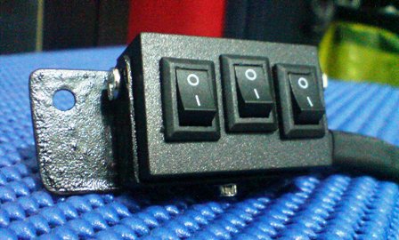

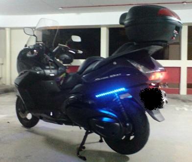

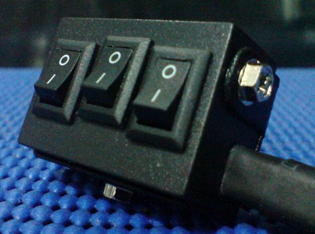

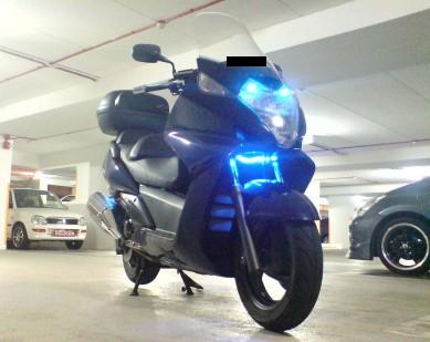

project "blue lighting" finally completed :lovestruck:
enhancements are:
+ 3-rocker (1 for headlight, 1 for blue led lights, 1 spare) blackbox & mounting at left handlebar
+ headlight off switch
+ relocate hazard light to right throttle control
+ blue led undercarriage lights at front & rear
+ blue led position lights
next thing is... hope dun kenna stop by uncle sam :lol:
oh! almost forgot about the wire mesh protection (can see in pic) for radiator... many thanks to HelmetBOX! :thumb:

finally u appear..... hope to see u soon.
haha, pls dont say this. MIA 4-5months due to change job, become private investigator with SW... recently quit liow more time nw. damn siong ah that job, no day no night.
enhancements are:
ya switch box interesting.. U ask ur bike shop do or u DIY?? Come Come share share....

Your wing si bei "Beng" lei..
Keke :sweat:
6十年代 lau beng... 哈哈哈哈哈哈 :lol:
would have preferred the "knight rider" design... but can't find leh ;)

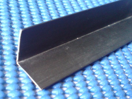

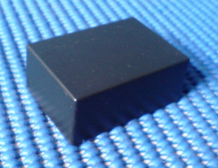

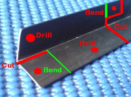

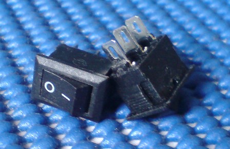

DIY... materials required: 3x rocker swithc ($1 ea), 1x black plactic case ($1.10), aluminium L-bar (think 10cm for approx. $1.50), wires, 3 screws.
i actually wanted to use illuminated rockershttp://www.cherrycorp.com/english/rockers/images/LR.gifbut the size isn't small enough. although can use a bigger black box, it doesn't flush with the handlebar as nicely as the smallish one
