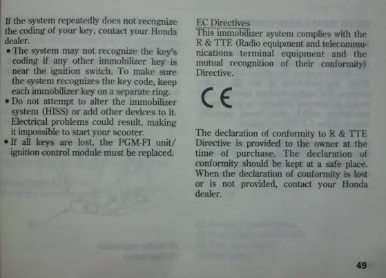

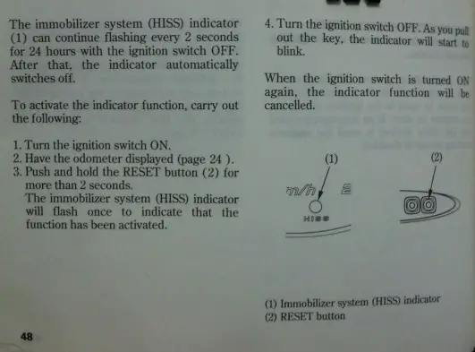

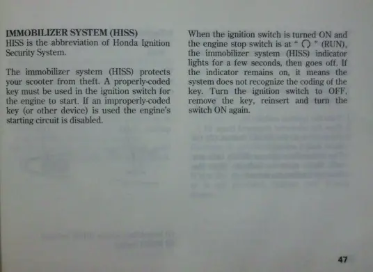

HISS = Honda Ignition Security System
About HISS
First introduced in 1996 for cars, this is Honda's unique, electronically controlled security system. A chip in the original ignition key recognizes signals from the Engine Control Unit (ECU) and sends a special ID verification signal. If the signals do not match, the engine will not start. In 2001, HISS was made available for Honda motorcycles.
Totally disabling the engine at the very heart of its ignition system, the system cannot be bypassed by either hot-wiring the ignition or exchanging the ignition switch module, thus effectively deterring joyriders and greatly reducing the possibility of ride-away theft.
HISS for Silver Wing
HISS works in tandem with the Honda's security coded keys; without the synchronised codes (commonly referred to as programming) between the key and the bike's ECU, its engine could not be started.
There is no need to worry if you do not see the red HISS light blinking, HISS is automatically active whenever the ignition is turned off.
The rider is able to manually activate the blinker by following the procedures in page 48 (see attached).
However, the indicator function will be cancelled when the ignition is turned on again. i.e. rider will have to manually activate it if he/she wants the blinker to be on every time he/she parks the ride :p
Other posts about HISS:
Additional HISS keys for SW
