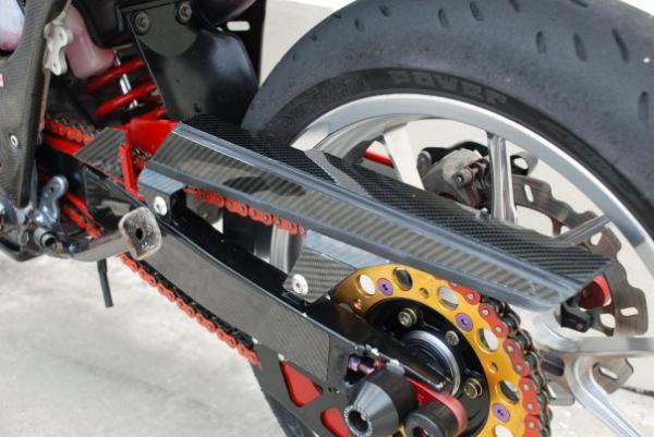

S100 chain lube bought from biketech..
my bike's chain after using S100 degreaser, and lubed with S100 chain lube..
minimal fling but kept your chain lubed.. one of the best lubes i've used after so many years of riding..
