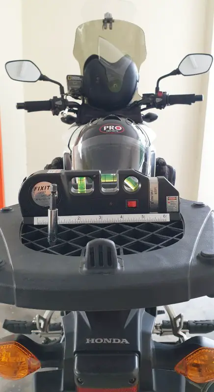

Hi guys,
May I check how should I fixed this problem? Any good and recommendation bike shop that I can go and fixed this?
I am not sure if the rack is slanted or the bike body of itself?

How is the rack attached to the bike? Should be 1 side higher/lower than the other. I dun use box so I can only guess the rack is the issue.

It may need to check these
Is the ground in horizontal ?
Does the centre stand keep bike body in horzontal ?
Is the rack mounted in horzontal ?

On 2/16/2020 at 12:22 PM, wlpoh said:
Hi guys,
In order to check the ground and rack balance. Place the level on the ground in front and behind your main stand, then on your base plate.
If the 3 read is more or less similar, it's the ground uneven.
