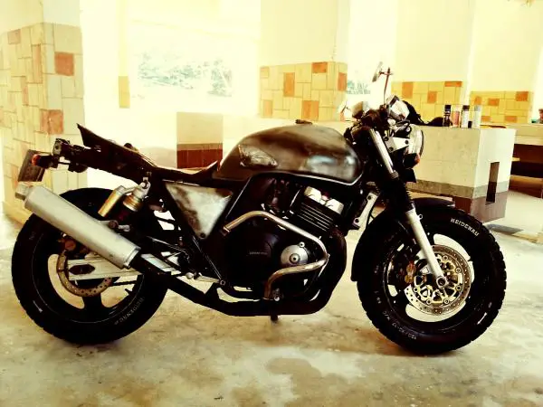

Yes it is. Niwei i used a cm125 seat for the cafe s4, cos the s4 frame slopes upwards halfway, i had to use a heat gun and flexed the plastic seat pan to follow the frame. Still oklah considering the w400-800 face the same frame issues.

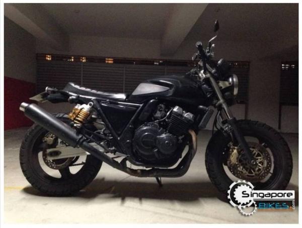

@sproketty my still uncompleted street tracker.
http://tapatalk.imageshack.com/v2/14/12/06/5b8734ee55a28d5a7002c766ce9654f7.jpg
Yet another cm125 seat used for it. Heeeee

--For the seat, I'm trying my best to Flatten AND lower it. I hope to achieve the old-school flat "uncle" style straight lines, so the bike doesn't look so aggressive. Basically this kind of look:
http://i1293.photobucket.com/albums/b595/DanielReyer/P1010635_zps109ed413.jpg
Unfortunately given Super4's aggro shape, this is not easy. To achieve FLAT, like you said, the only way is to make the front part of seat thicker, and then progressively thinner towards the end. To achieve LOW, I have no choice but to try and make my own DIY pan. I originally wanted to reuse the plastic base of the original seat, but unfortunately the original seat is too high. I also tried to re-use the original seat bolt mechanism. But the mecahnism also means raising everything by 2 cm. So I guess I will forego this convenience feature for now. Right now I'm trying to make a DIY fibreglass pan. My vision is this fibreglass pan will be "universal" and i can attach on different cushions as and when I want. Dunno if I'll be able to DIY it. Will def post pics of the process if it is a success.
--Thanks for tips on what to do when change to bigger tyres. When you say "shift axle backwards" does this just mean u shift it backwards within the "gap" that allows you to tighten your chain? Or did you mod the entire swingarm and shift it backwards?
--Your "burnt look" is awesome :):) did you really burn it or is it a spray on effect? haha. From the way you do your "burn strokes" you are a talented artist man...
--Last but not least, I'm surprised that there are so few super4 cafe / tracker mods! As far as I know, I've only seen 3 on this forum (yours, sprint74, and one more guy). Given that super4 is singapore's most popular bike, I hope to see more!!! :p
you diy-ing your own fiberglass pan?? thats cool! I wanted to do that but I had trouble with the shipping of the liquid resin.
I shift backward within the gap only. If i had to buy new swingarm, i think i will cry. hahaha
the burnt look is just a spray on effect with matt camo green and some dabbing with newspapers. siao ah want to burn fuel tank. my insurance TP only. no fire or theft included. :p
