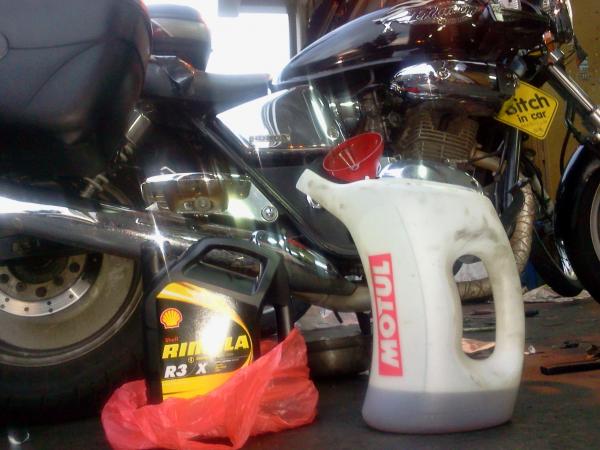

Thanks to @Lexanez I now have access to HDEO at low, low Malaysian prices. Rimula R3X gives a rather different feel to the bike and its by no means a disadvantage. The differences are mainly : -
1) The capability to idle at stupidly low engine RPMs and almost quiet with no vibrations (this can save fuel - I managed to idle at like, 700rpm instead of 1500 once the oil had warmed up)
2) The clutch bites HARD now giving much more efficient driving and higher torque at low RPMs. You could almost dump the clutch and start moving right away, as opposed to high performance bike oils which optimise extreme rev horsepower at the expense of fuel efficiency. A more responsive clutch makes for more efficient hill climbs and very responsive acceleration if you like to accelerate out of corners supermoto style (slipping the clutch deliberately).
If you dump the clutch at extremely low RPMs (or wrong gear selected) the engine surprisingly does not sputter and stall as easily. It just keeps biting and pulling. Just like a diesel lol.
3) Rimula R3X is absurdly cheap compared to good motorcycle oils and as far as I'm concerned, anything capable of surviving extreme-duty loads in a heavy vehicle, or used to cool a 150,000 RPM turbocharger, is more than good enough for a motorcycle. This is one oil that actually improves wet-clutch performance, which even in the world of JASO-MA spec motorcycle tailored oils, is a very rare thing.
I might ride a lowly single cylinder 4 stroke 2B bike but...
Those of you who have rode with me on big bike convoys might notice I exceed 10,000rpm on a regular basis since I'm usually tactical commander or sweeper and convoys are run at Class 2A speeds.
Risks? None whatsoever. Bikers in Australia, the USA, and even in Malaysia swear by HDEO. (check out Slackrider forums in Malaysia). Or just ask your resident experts like @Isopropyl in this thread.

Day 2 of running HDEO - I'm loving the punchy low end torque and easy, sharp clutch engagement. Valvetrain is also much quieter on a cold start. (My bike being a "scrapyard" level machine when I bought it, has a noisy valvetrain and clutch by default and only a handful of expensive bike oils succeed in cushioning the noise).

I'm pleased and very, very surprised to report that Rimula R3X delivered consistent performance throughout! The engine was smooth and quiet all the way, delivering punchy low to midrange torque regardless of operating conditions. No oil consumption so far.
