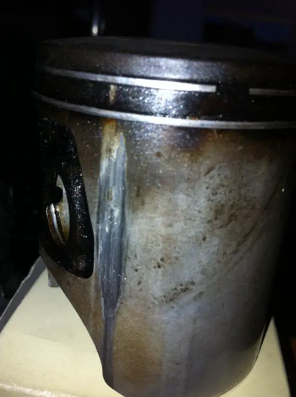

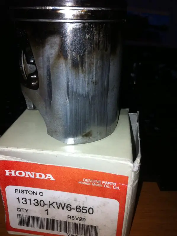

here are a few pics of my old, seized, not original piston~ take note the one line down scratches on it, that is the effect when seized, NO JAM, jam is the top of the piston cracked or deep cut!
PS: That box is my current piston~ shows that it is not a local piston, made in thailand

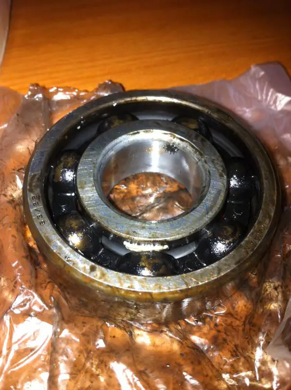

@wait4me see this pic below is my old spoiled engine bearing..
[ATTACH=CONFIG]256041[/ATTACH][ATTACH=CONFIG]256042[/ATTACH]
[ATTACH=CONFIG]256040[/ATTACH]
