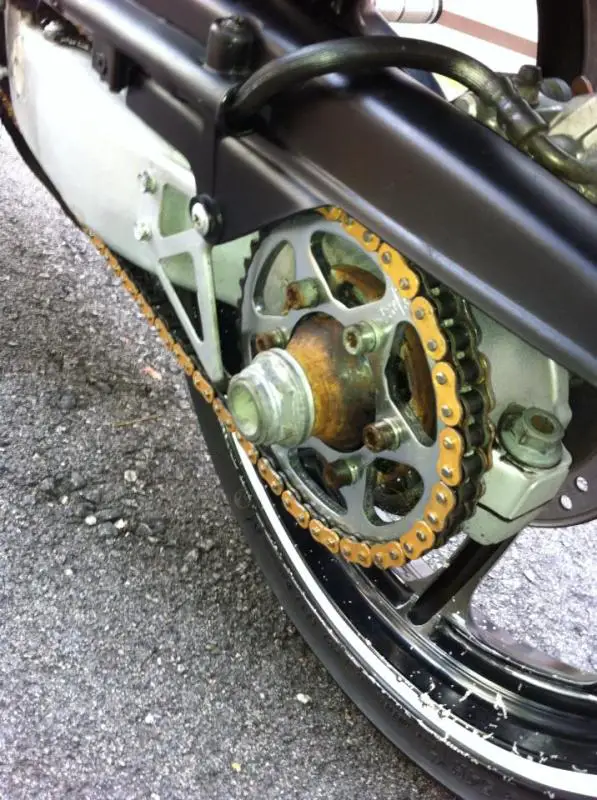

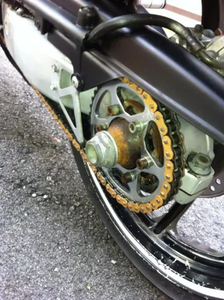

Hi bro, how to know (identify) that the current bike using the sprocket is which type "520" or "480". :o

Some people also play 520 or 428 hub also. 520 is stock SP, heavier chain, heavier hub, better for acceleration. 428 is lighter chain, lighter hub, good for top speed.
Thks Bro
But what does 520 actually mean? Been googling round & seems to be talking more abt the chain design & weight?? Do they also refer to the front & rear sprocket teeth number??

This is the original 520 hub.
This is the 428 hub that does not originally come with SP.
"lighter chain = less rotating mass = better power delivery due to less hp lost to wheel"
But it's not say jin big difference. The bigger difference is your sprocket sizes. I can't remember what i used for front, but my rear was 42.
[ATTACH=CONFIG]327891[/ATTACH]
[ATTACH=CONFIG]327892[/ATTACH]
Wa... awesome... :eek:
Now at least I know how it look like also picture will tell thousand words. :D
Thank bro for the value info, ;)
Thnks bro
By the way, does the inspection will pass if change sprocket sizes for front & rear to 428 hub?
