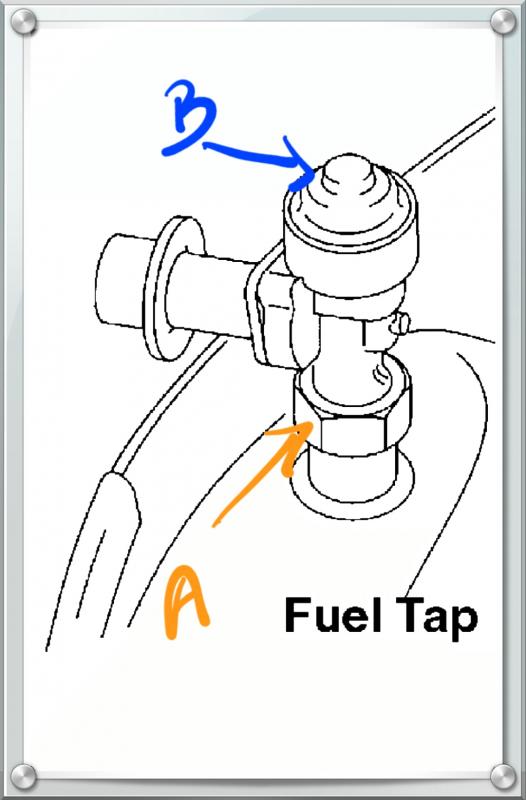

If fuel cork is loose, need to remove the fuel tank. You will see like some metal tap thing protruding out from the tank. Use a spanner to tighten the nut. Sometimes, if you unscrew the tap, you will see the rust build up there also. The rust is from your fuel tank, then collect over there over time. Just use petrol to rinse away and put back.
Hi bro (Heathx), the nut to be tighten (Fuel tap) that you early mention where is that located at?
The "A" or "B" or other place?
Sent from my SM-N9005 using Tapatalk

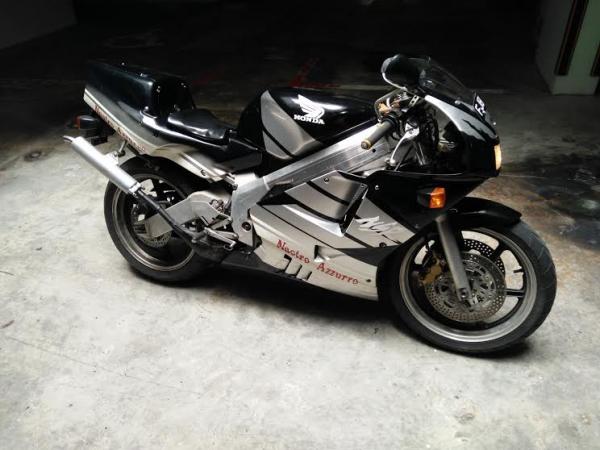

hi guys i am very new to bikes. just got my SP 2 days ago (FS plate) and experiencing abit of problems. upon hitting 120kph, the bike seem to struggle to reach higher speeds. went to a shop in JB and the mechanic told me need to "top overhaul" or "wash the engine" i am not very sure what he means, but what i am sure of, is that the previous owner changed the block, gaskets, piston, rings, conrod, seals. and he just finished running in the engine. so what could be the problem?
fairings condition are quite bad scratches and cracks here and there and the fairings are not exactly of the same color/design, a slight dent on the fuel tank. any recommendations on where to get brand new coversets and tank? pls advice.
right side of the headlamp has melted, looking to get a new set of headlamps.
thank you guys
[ATTACH]329196[/ATTACH]
In my case, i tightened the A part. Sorry for late reply, i was away in Hong Kong getting fat. lol.
thank you guys
First question that comes to mind is, why you buy such a bad condition SP? >_
If the exterior so chui, what makes you think the owner will take care of the interior? Previous owner claimed changed everything, did he show you receipt? Did you open up the engine to see if all the parts were new?
Anyway, to address the issues you face.........
Struggle to go above 120kmph can have many reasons. First possibility is engine condition not good. Second possibility is your valve have issue (choked or not working properly). Third possibility is your exhaust system choked up. There are other possible causes also, but the three above are most common. If any shop or mechanic tell you must overhaul without opening up the engine to inspect the piston and block, don't bother with them. There's no way to judge that an engine need overhaul just by looking from exterior, unless it's already jammed.
All the parts you need for SP, you can get from Everfit, Ever Success, or FJT Parts. Just google them and you can find their location and contact already. These 3 are authorised dealers for Honda parts. All located at Rowell street area so if one shop no stock, the others are within walking distance. Fairing is a give and take, cos sometimes the holes they drilled not accurate one, so the fitting a bit off. But shouldn't be too big of an issue.
RIDE.
2012 - 2015: Honda NSR150SP
2015 - current : Honda CBR600RR
He had receipts of the overhaul, the bike sounds good and proper. It's just that the outer appearance isn't very good but I can change that myself, most importantly, it must be able to run. It has no problem with moving off, just have problem with hitting higher speeds. Thanks for your reply bro, it was helpful :)
Glad that my advice was helpful to you! If that's the case, then perhaps you'll want to skip to check valve or exhaust first. If exhaust is choked, you will need to decarbon it, and either change or wash your endcan. You can scroll to the previous few posts where we discussed this. My endcan was choked up badly once. My rpm couldn't go past 6.5k, and my speed was limited at 100kmph at most. Just the endcan choked alone can cause NSR150SP to become C70...
Just another thing. The fairings and tank total can cost up to $500ish, so be prepared to face that kind of price. I had to buy a whole set before after a highside at pasir gudang. Fuel tank no stock, so i got them to knock the dent out, then putty the exterior to make it smooth. Bikes that have survived crashes, don't expect alignment and fitting of fairings to be flawless, sometimes you may have to drill a hole or 2 to fit the fairing comfortably. If you forcefully fit the fairing according to its initially drilled holes, it may cause the fairing to crack prematurely due to increased stress.
