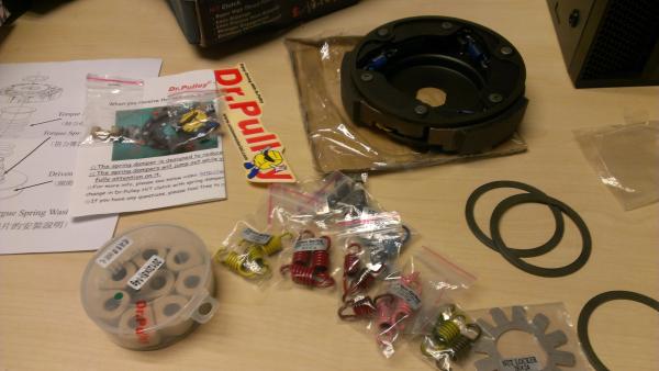

It's quite complex piece of kit compare to normal scooter clutch. Basically it how it works is, it has one set of clutch springs to hold back the shoes and engage at a certain rpm. Different strength springs(3 set) are included to tune at which rpm the clutch engaged.
After the initial clutch engaged there are secondary springs that hold back a lock-up mechanism which locks at a rpm range determined by pillow springs strength(4 sets).
On top of that this is Ver. 2 of HiT clutch. It has some lateral spring support to prevent sideways play which reduces clutch noise during engagement.
The three rings you see in the picture are Torque Spring washers. It is stacked under the torque spring to increase its tension. It has a smaller degree of effect as compared to changing to racing torque spring.
Overall it is a very nice piece of kit which has a lot of thought put into it. I will be putting it to use when I get the AD3 and run in.
