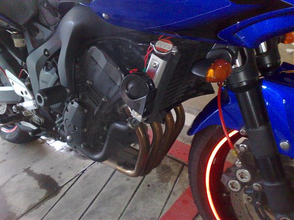

another DIY session. It's a simple one. Got a pair of electric horns from lab at 16bucks.
Bought 2metres of wires, 4 m6 and 1inch long screws, 4pairs of female connectors and black tape.
Next diy, should be changing to hid's instead of dual headlights. Still considering though. Haven't do my grounding and rewiring yet.

Is the electric horn louder than stock? If so, how much louder?
For HID, take note that it is not legal to install on vehicles that do not come with HID light as stock. Just letting you know in advance before you decide to donate $$$ to LTA :)

hopStick;4895077']another DIY session. It's a simple one. Got a pair of electric horns from lab at 16bucks.
Piece of advice. Make sure the open end of the horn faces down or backwards. A horn is not a ram air device. :D
At that angle, rain will enter the snail.
http://img.photobucket.com/albums/v161/DeusXMachina/Lean2a.jpg
  Quote
a little advise.
if u're replacing the TWO stock horns to TWO after market ones, make sure u add a relay just case.

  LollyPoP said:
a little advise.
thanks for the advise, the relay is provided in the package. It took me the longest time to figure it out. The rest is easy. Difficult to find a spot for the relay, connection wise is idiot proof, just follow the schematic diagram
Thanks for the advise, will change angle tomorrow morning. Hope the wires are long enough. Eyeing on hid's now. Hope to get a decent set and try on it. Will post pics when i'm done.
