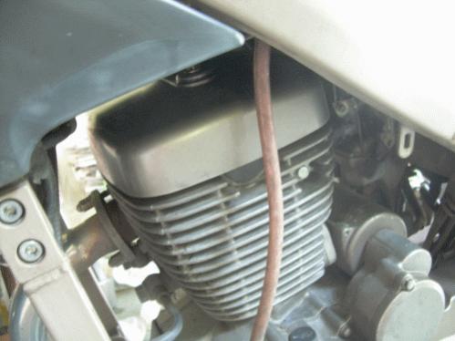

http://i296.photobucket.com/albums/mm189/siriusjones/scooter.jpg
what is this tube sticking out from under the petrol tank? it was hanging loose near the engine part and i sort of flipped it over and it just came out like that..
tat's the tank top drain tube, it is connected to the fuel filling cap area in case when over spill during top up.
tube suppose to be route at the back of the engine with other drain tubes eg. carb n airbox.
there is a something like a bracket welded at the swing-arm to hold these tubes together.
