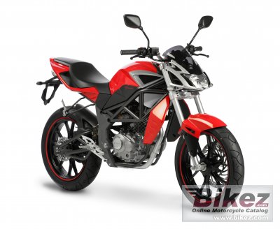

i dun think it's a megelli coz the frame is not the same.
i've no idea wat is the brand coz it's a concept bike, not in production yet.
anyway it's a italian bike shown in ECIMA milano motorcycle show 2009.
do a search for EICMA 2009 in youtube n u can find many clips.
maybe it's a cagiva mito replacement becoz 2-strokes n carb bikes can't meet euro4 emission std.
all new bikes will be EFI, problem with EFI will be electronics, sensors, fuel pump n injector.
it means any problems cough up will be expensive replacement of components.
