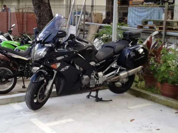

this beautiful bike is taken at ang mo kio :)
Hahah...nice bike!! How did u managed to snap that pic? Btw..tats mine!!! Bought at the supplier at ubi.
