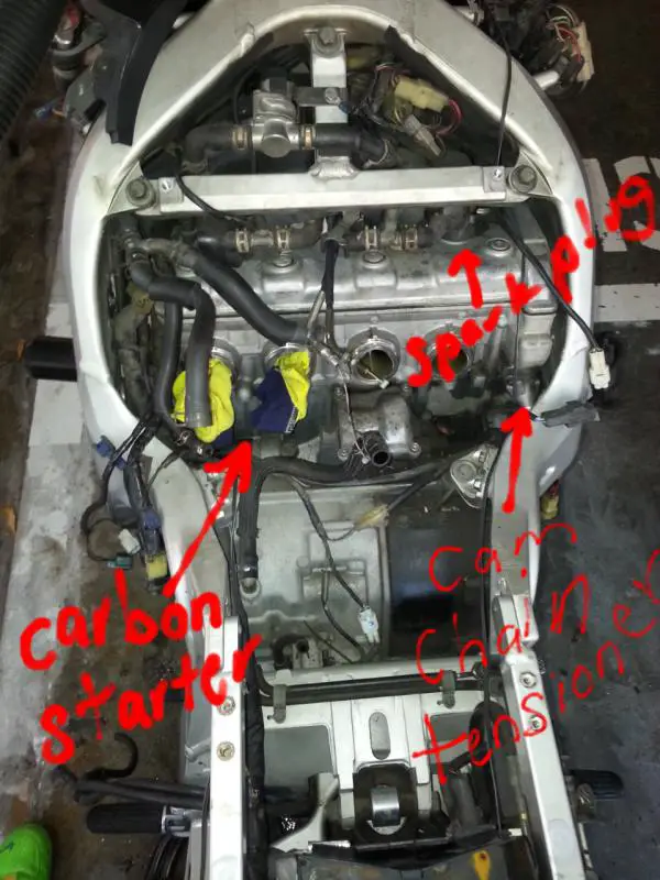

wanna diy in doing together? i am interested to do the throttle bodies sync as well. i have found out the location of the mixture screw and vacuum outlet thru my previous disassemble of my tank.

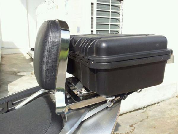

Back rest & Tool box for sale
- Customized Backrest
- C&C special base nut
- C&C base plate
- Pelican Storm Case im2100
PM for price.
- C&C base plate
Whatsapp @ 96946766 for price. A break down on price will b given while
Initially done up.
Low ballers pls **** off.

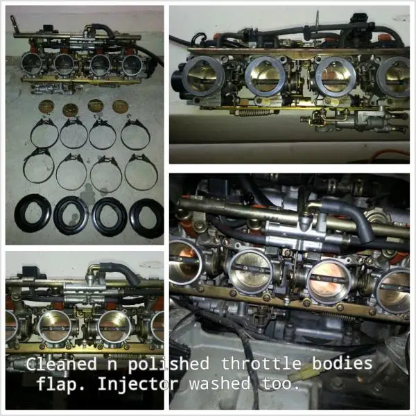

My throttle bodies DIY cleaning. Still waiting for my cover set to be ready frm paint shop.
http://i59.photobucket.com/albums/g313/funkyvtec/IMG-4077.jpg
Previous Rides: RXK 135, S4 Project Big 1, S4 Vtec1, ST1100 Pan European, Cbr954, K7 600, FJR1300 ABS, SilverWing FJS 400.
Current Rides: FIT 1.3 GF MoonRoof.

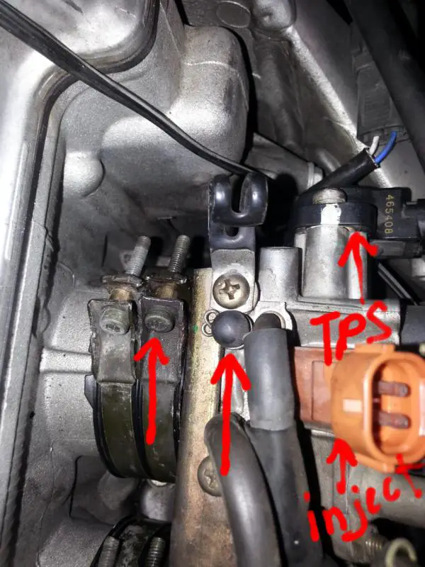

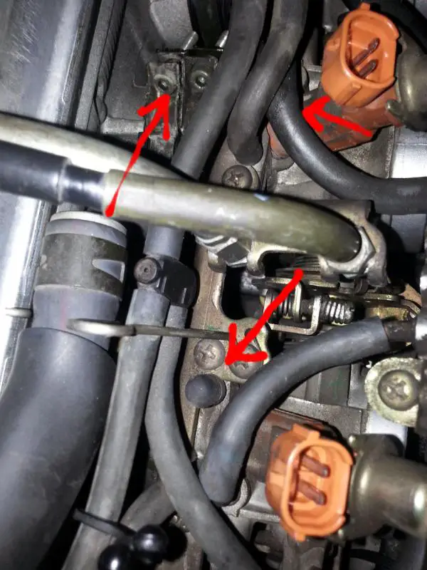

For those keen to diy fyi:
The black rubber gromet which has 4 in total use to synchronize ur throttle bodies.

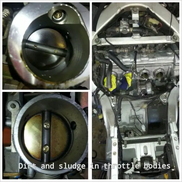

[ATTACH=CONFIG]279140[/ATTACH]
[ATTACH=CONFIG]279141[/ATTACH]
Bro, looks like you're doing better job than the shop lei. Maybe can help do mine next time.;)
