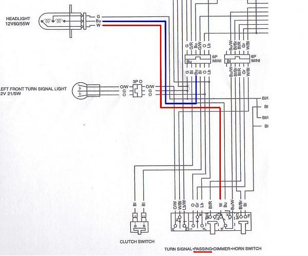

  TripleOneZero said:
need help.. thinking of installing a switch for my low bean.. so tat my passing light will still work when i off the low bean.. any guys can guide on which colour wire to strip? thx! :thumb:
cut the wire on the right (blue), the one beside the gnd (black). the one on top (white colour) is the high beam.
u may use a voltmeter to double check
u may refer to the s4 manual circuit diagram also.
in case u wan to be sure.
the red colour is the one that link to passing switch which is equal to the high beam, thus u dun cut that. cut the blue colour. the black/gray is the gnd.
Thanks for the great info.. finaly gt my headlight switch done.. :cheeky:
