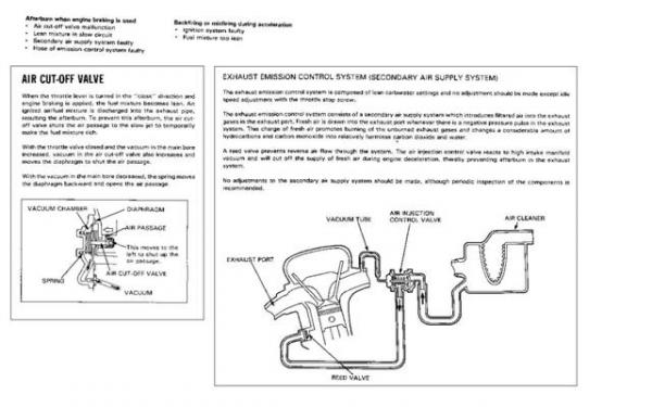

wow... im actually confused becos of this in the service manual.. =S
http://dropproxy.com/f/254
Edited by sawfly

Hi sawfly,
Agree with you, you are confused.:)

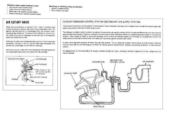

The attached diagram/s is about EECS - to provide an alternative source of air (oxygen) to the hot exhaust manifold (not combustion chamber) during normal deceleration (gradual, not sudden) in normal engine operation. Its purpose as named is to maintain a cleaner emission from the engine. But, if the vacuum tube is at fault (clogged, leaking or missing), other problems, including backfires, are possible.
Hi sawfly,
Err.. how about the air cut off valve in the pic on the left? Its not part of the secondary air system for emissions control. .
edit: im including this for reference.. see 8-7 for the air cut off valve..
http://downloads.hondatech.info/Moto/Common/Honda_Common_Service_Manual.pdf
the air cut off valve is located on the carb.. thats why i confused when they say it activates to *cut off* air during close throttle conditions where it will suddenly become lean.. by cutting off air it will richen the mixture and prevent a lean mixture backfire resultant from the high vacuum state that causes a misfire..
Sent from my GT-I9300
Edited by sawfly

The ACV is a "governor" in a seperate circuit (different from the EECS) of the air/fuel intake system.
As appended in page 8-7 of the Service Manual:
AIR CUT-OFF VALVE (ACV)
When the throttle lever is turned in the "close" direction and engine braking is applied (effected), the fuel mixture becomes lean. An ignited air/fuel mixture is discharged into the exhaust pipe, resulting the afterburn. To prevent this afterburn, the air cut-off valve shuts the air passage to the slow jet to temporarily make the fuel mixture rich.
With the throttle valve closed and the vacuum in the main bore increased, vacuum in the air cut-off valve also increases and moves the diaphragm to shut the air passage.
With the vacuum in the main bore decreased, the spring moves the diaphragm backward and opens the air passage.
Copied and pasted, from another source:
The ACV is an extremely important part of the air/fuel intake system that is frequently missed even by competent mechanics, most of whom are not aware of its existence or how it functions.
The valve is a "air blocker", along with the carburetor, serving to restrict air flow and increase the air/fuel mixture ratio when the carburetor slide is in the lower rpm range up to throttle fully closed, so that the engine will start and idle smoothly and during sudden acceleration and deceleration, meaning with the throttle at any position.
When typical starting requires heavy and prolonged choking to keep the engine running, when stalling and uneven operation occurs during normal running temperature and when "back-fires" while the throttle is closed while cruising to effect engine brake, most tinkerer will starts "adjusting" the air screws and try overcoming the "problem", only making the matter worse along with reducing their fuel mileage.
Running with faulty ACV can cause severe engine damage or failure. When the ACV is not functioning, the engine pulls nearly total air in the low RPM range through the carburetor into the combustion chamber. The air/fuel ratio is extremely poor resulting in pre-ignition, generating an enormous amount of heat, with no power, which is trapped a longer period of time in the cylinder before the exhaust valve opens.

wow... wall of text.. but i unds liao!! thanks for clearing up!
just wondering now when the mechanic say replace air valve.. dunno if its ACV or the EECS air valve though.. looks like i should just go replace the thing liao!
operate a vehicle in a way that you benefit other road users pls - and meanwhile, stop whining! be responsible and be safe.
Replacing it is the correct move! Enjoy your ride!
