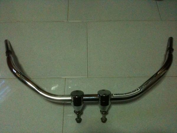

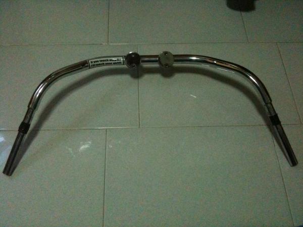

K, got my beach bar but got another problem on hand! Where and how should I shift my IU unit to? Hmmm.... any suggestion? I also need to get the Throttle/Handle grip (is that wad it's called?) from LAB.
