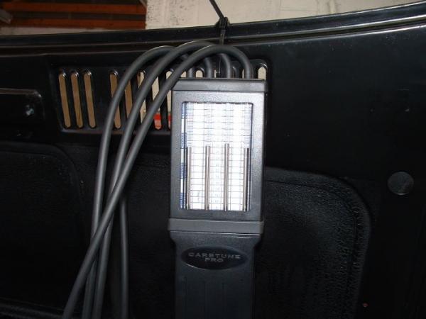

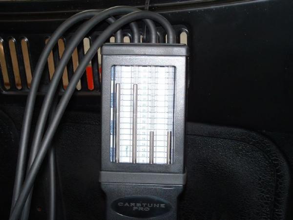

some photos i did a random search for easier understanding.
un-tuned carb
tuned carb
2012 - 2015: Honda CB400 Spec3
i think price still $185
i dun think exhaust changing will affect carb air intake. exhaust change is more of a dyno tuning.
dyno tuning is adjusting the fuel and air to maximize your exhaust performance. carb tuning is just making sure all 4 valves are taking in the same amount of air.
perhaps i should say carb balancing rather than carb tuning to avoid confusion. XD
un-tuned carb
[ATTACH=CONFIG]309799[/ATTACH]
tuned carb
[ATTACH=CONFIG]309800[/ATTACH]

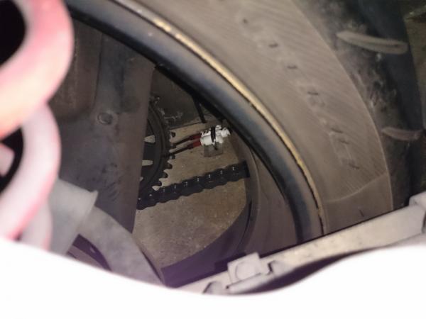

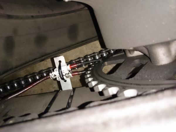

according to the design of scott oiler the nozzle should be in contact with the sprocket. however only one side will be oiled, unless you increase the flow to quite high that it 'overflow' to the other side on the chain but this will cause crazy flinging of oil.
i am currently doing some self modification to create a dual injector which scottoiler sells for like a quarter of the price of the oiler.

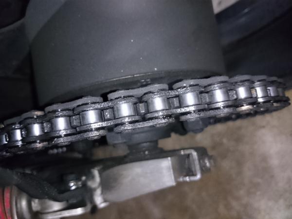

to anyone interested in dual injector for scottoiler. this is what i did.
from opposite side view
top view
both side of chain is lubricated
