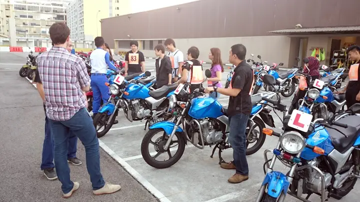

According to the tender documents on government procurement portal GeBiz, the trial is to be conducted on selected Class 2, 2A and 2B motorcycles, which are to be fitted with analytical equipment such as sensors and cameras.
The tenderer is expected to supply two motorcycle units for each class and set up automated testing systems at the motorcycle course stations within the test circuit at the Singapore Safety Driving Centre (SSDC) in Woodlands Industrial Park.
