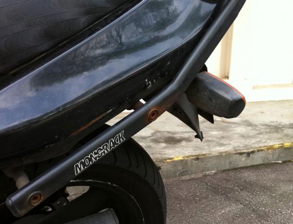

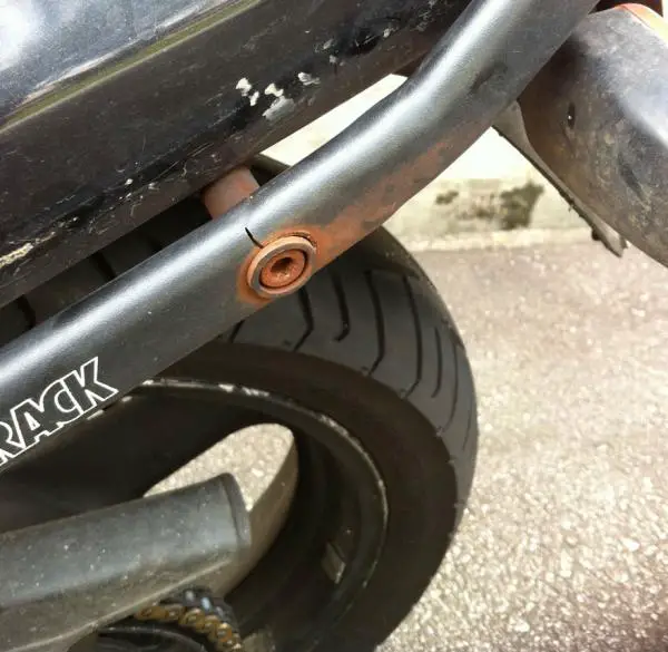

Hi guys!! Need your kind inputs and advices, the left side bracket that's supporting my Givi 40L box is starting to give way and as seen in the attached pictures, it can give way anytime now.
Is there any reputable place to get it replaced or welded?
Thanxx.

Well...IMHO....Yes... and No!
Yes... You can get some one to weld it back...I'll PM you his number.
But!
No....!!! Not recommended as the rust can be seen attacking from 360*, most likely the internal of the hollow section is rust out too...
Replacement would be a wiser choice...

Get it replace ASAP!!!
It happened to bro dragonforce's when he's still on S4 & with pillion & box, & @ up north somemore..
had to improvise with a couple of cable ties.
can forget about welding, cos the material is not really suitable for welding.

You do not want to be riding and then later pick up your box on the road. Remove your box to unload the rack and get it replaced asap. Danger to yourself as well as other road users. Ride safe fren...
yup.. my givi rack broke into 2 while i was up north. lucky near customs, with kev around to help secure the rack slightly with cable ties.. so get your rack replaced.. so check your rack once in a while, as well as the screws, make sure they are tightened.
