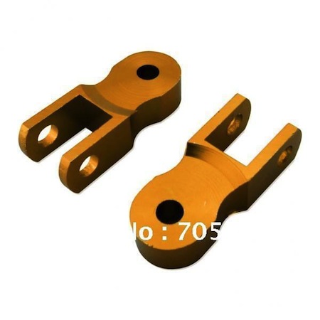

Lagik satu... maner nak dapat this shock riser??? since nak tukar tyre might as well satu kali jalan...
[ATTACH=CONFIG]287424[/ATTACH]
maklum lah badan dah besar, box pun besar, rasa2 nya macam tu gantung dah tak bleh angkat lagik!!!
terima kasih kerana sudi menolong.
For s4 nak get high mileage tires get sport touring ones mcm michelin pilot road 2 or 3...metzeler z8 or z6...kalau nak murah siket pirelli diablo..cheap2 tapi hujan licin sikit..
As for the riser bole beli ah ah boy..aku recommend not to fix it as it upset the geometry of the bike,high speed cornering conferm wobble giler..plus the riser takde proper eye to facilitate the movement of shock bila absorbing bumps which in turn causes binding...

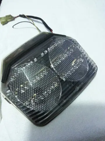

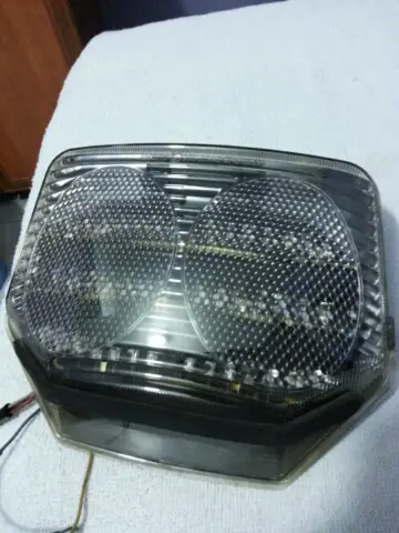

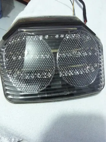

Hi, I'm selling my CB400 VTEC3 LED Integrated Tail Light. SELLING AT ONLY $50. Used only once, PERFECT CONDITION. Selling due to changing bike. Cash and carry. Location Redhill Road. MSG ME AT 90110467.20130430_213119_resized_1.jpg20130430_213058_resized_2.jpg20130430_213036_resized_3.jpg
