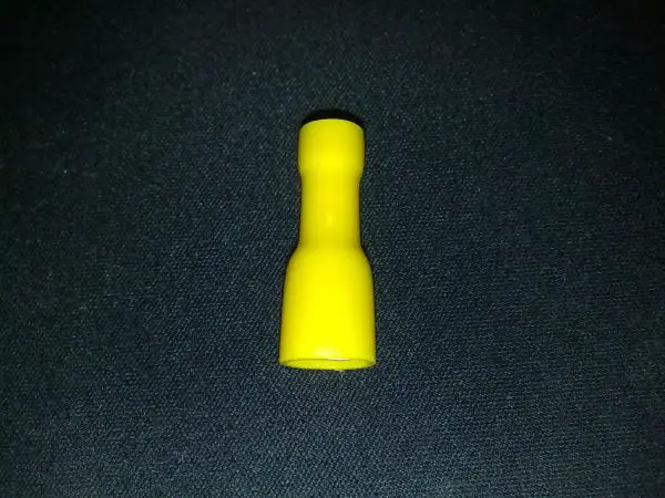

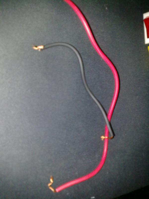

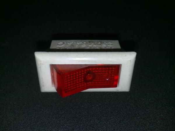

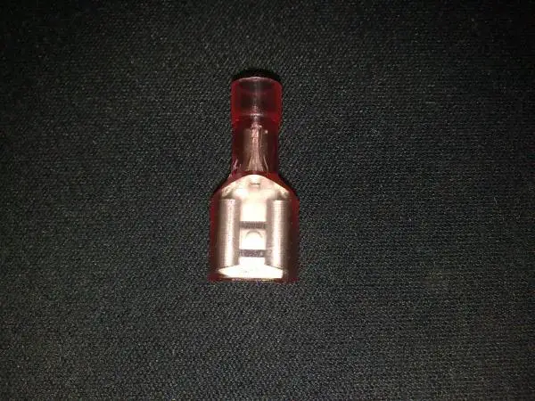

bro,
here is the main list of items
the switch get the 3 pin or 4 pin ones
i don't have the signal relay pic
that can be bought at LAB at $6-$7
just tell them signal relay
the connectors either the pink or yellow one also can
just make sure it fits nicely on the relay and switch pins
also do consider getting heat shrink to waterpoof your switch and the conenctors at your switch area since they will be exposed
as for mounting points and way to mount the switch its up to you and your imagination
