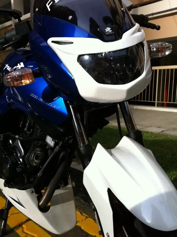

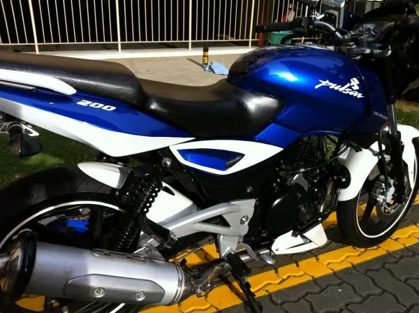

Be warned! As the title suggests, this will be a random adventure to UM! haha. Let the pictures and captions explain it all. Enjoy! :cool:

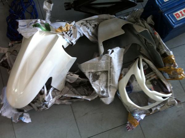

The goods that were flown all the way from Indo. Unveiled for the very first time in UM. :sweat:

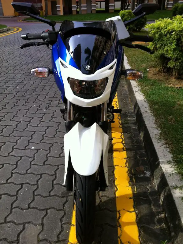

And who else who can handle it better than our Trusty Ah Teck? :)

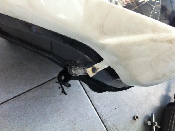

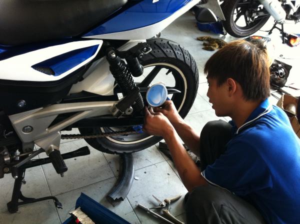

The only downside to the product. Only has 2 support screws (stock is 4), and there's a bit of gap after installation. But nothing that you can't modify to make it suit to your liking!

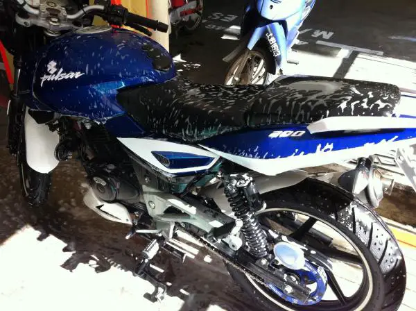

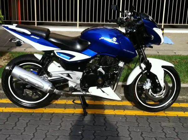

And of course, nothing feels better than having a thorough wash up (especially if it's anything white!) after the bike has gone through a transformation!

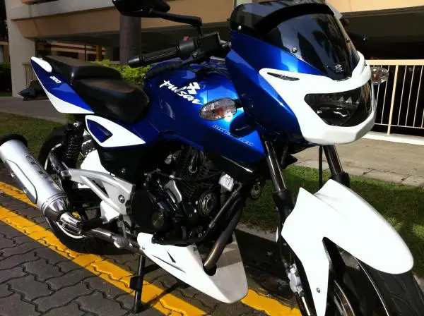

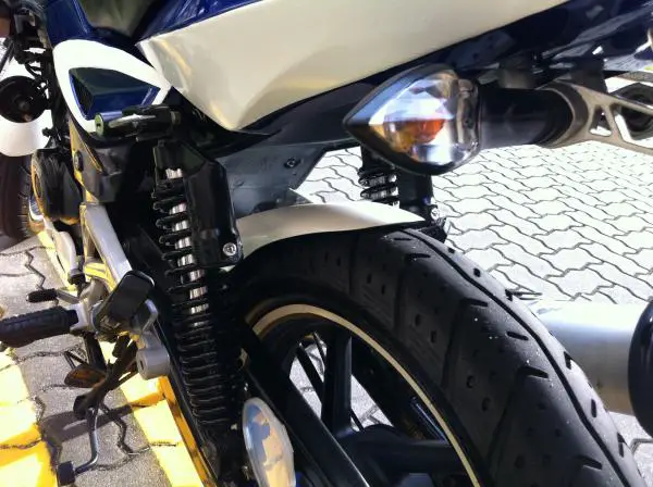

All the 4 items! Head cowl, Front Fender (short tail), Belly Pan and Rear Hugger!
The typical different angles of view... :p
[ATTACH=CONFIG]205134[/ATTACH]
[ATTACH=CONFIG]205143[/ATTACH]
[ATTACH=CONFIG]205144[/ATTACH]

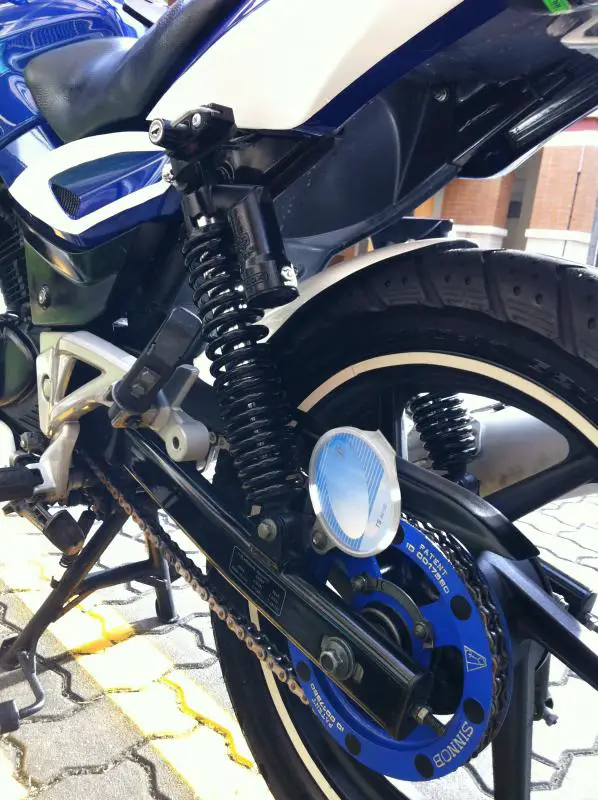

[ATTACH=CONFIG]205146[/ATTACH]

[ATTACH=CONFIG]205148[/ATTACH][ATTACH=CONFIG]205149[/ATTACH][ATTACH=CONFIG]205150[/ATTACH]
[ATTACH=CONFIG]205151[/ATTACH][ATTACH=CONFIG]205152[/ATTACH][ATTACH=CONFIG]205153[/ATTACH]
