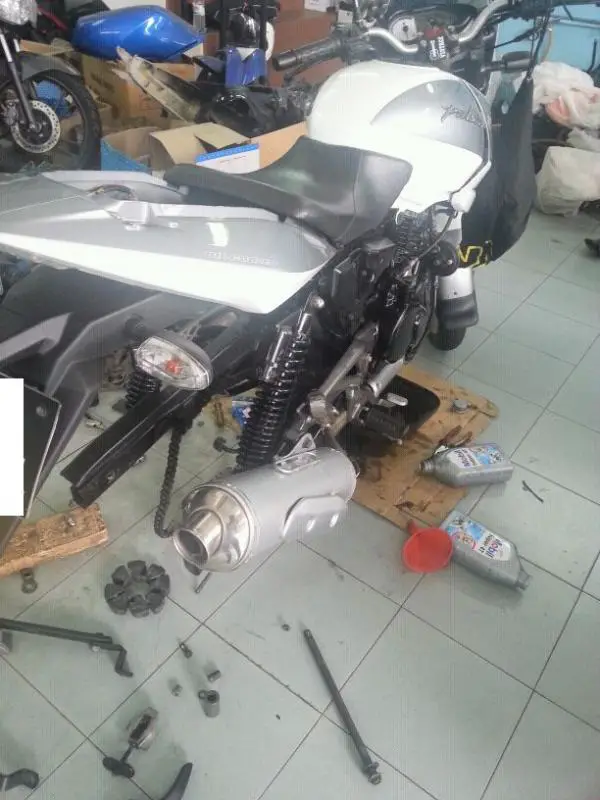

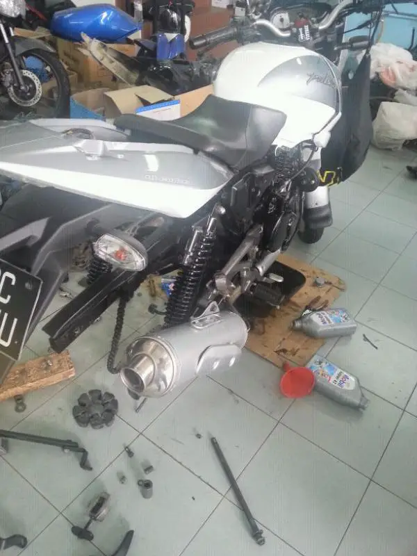

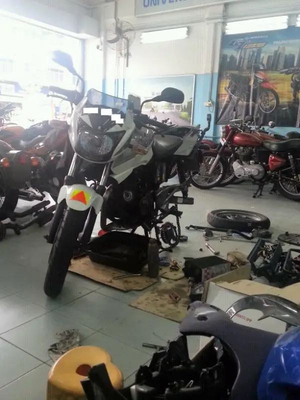

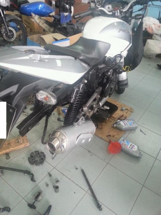

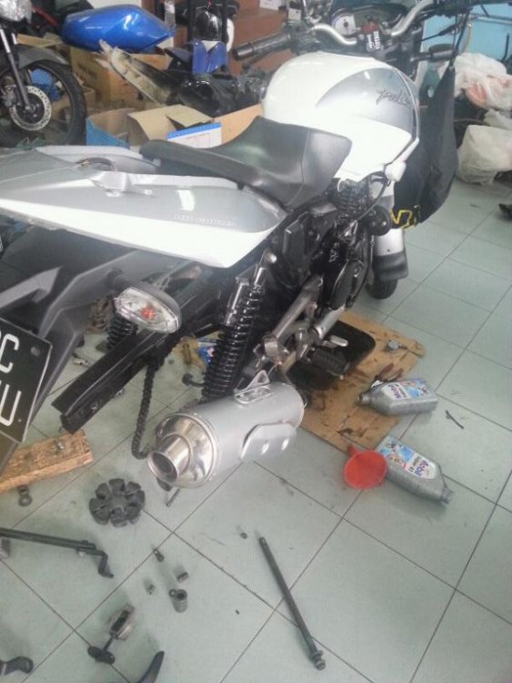

I have now a more stable ride.. this is a proper P200.. I am still monitoring on the FC to make sure that engine is in good shape apart from the sound.. so far its about 33km/L.. Ride at mostly 80km/h ++.. I didn't get the mech's name.. he is always at the salesroom side.. i also didn't want to take picture while the guy was doing it.. not very nice..
