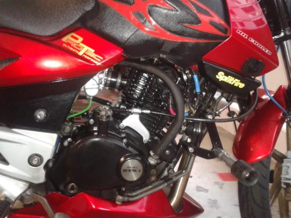

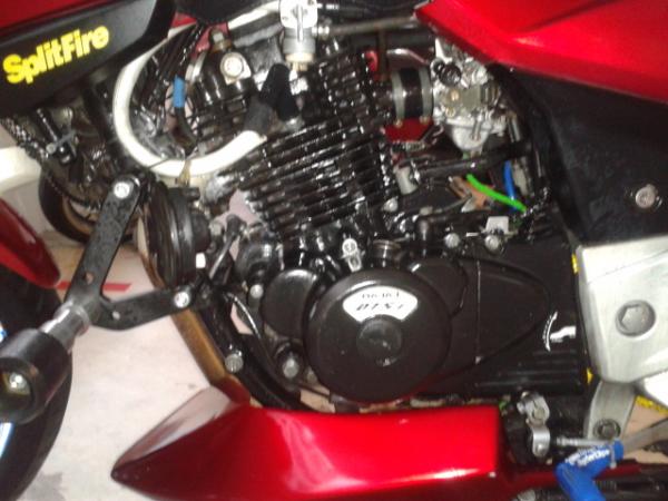

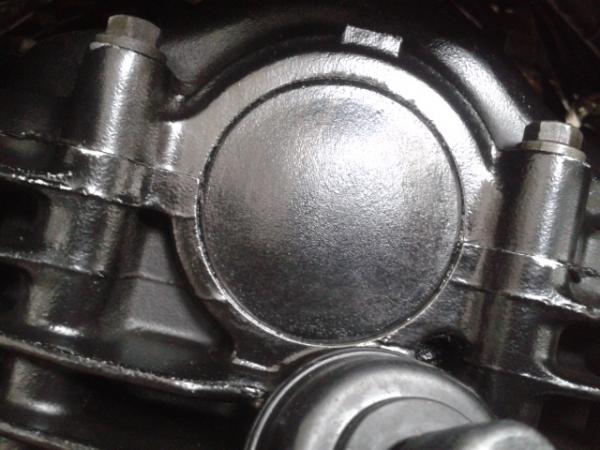

Camshaft Cap and gasket leaked ??? ..... nay

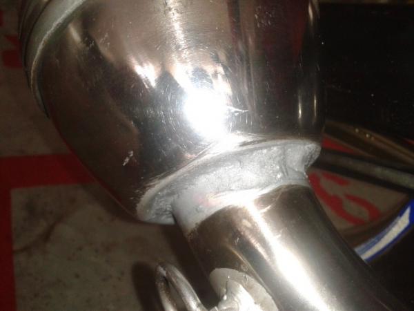

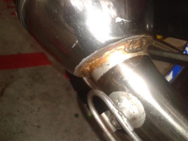

Rusty parts ... hmmm no worries
2012-08-31 17.00.42.jpg before treatment 2012-08-31 17.03.21.jpg after treatment
rectified wif this

wash clean lube and shine
