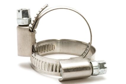

I think you should tighten or adjust it for safety.. if its worn then just change.. better than wobbling with cars all around you..
I am now thinking of using hose clamp.. the really big ones.. article-new_ehow_images_a07_8g_5s_install-hose-clamp-800x800.jpg

I am now thinking of using hose clamp.. the really big ones.. [ATTACH=CONFIG]257957[/ATTACH]
Wah!!! So big..

1)Lay spring washers between them. 2)Or use electrical tape and wrap the screw thinly, it might bw abit tigh to screw i. the nut but it will stay. Vinyl wont melt much.3) place another nut on the existing nut, means use two nuts. and lock them opposely. Or 4)
Or remove the exhaust shield. . .. HEHEHEHheheeh :D
yea!!
i'll remove the shield and wrap it with exhaust wrap.. remove the root of the problem..
anyone know the price of the wrap? if its too expensive.. i will just remove the heat shield.. :(
After a few advise from you guys :cheers:
Dun think I will use the ring to secure the exhaust shield by hooking it at the middle of the pipe..

yea!!
