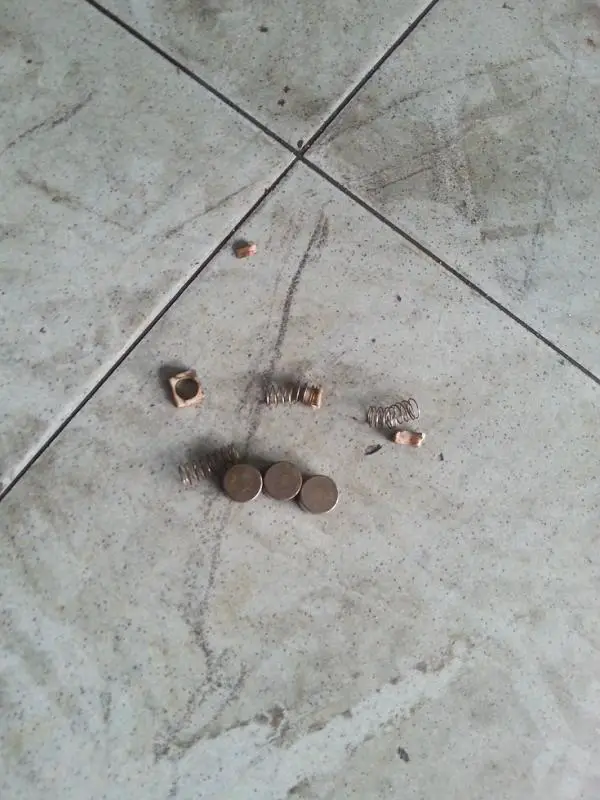

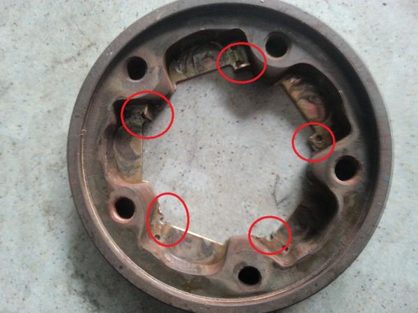

i suay la.. starter motor changed.. 3 of the hooks were gone and the components are pounded to bits..
thank man! I need it.. im almost losing patience already..
my apologies for the ranting but i need to get it out to the ppl who sold me this bike!
Bajaj Pulsar 200 DTS-i - 31 July 2012 - 27 March 2014
CB400 Bold'or SPEC3 - 27 March 2014 - Current
[ATTACH=CONFIG]259617[/ATTACH][ATTACH=CONFIG]259618[/ATTACH]
Oh bad luck, man, but luckily you didnt have to open the engine again.
That part is actually not starter motor, it is in the magneto assembly, I think it is called starter clutch body kit or something like that. I had got the whole magneto assembly changed in my previous P180 UG3, cost 220$, heart pain.
Now, looks like, you have already opened almost all parts of bike that can cause a problem and fixed it. You mentioned you bike meter was stuck at 99999 rite, I think its previous owner was a dispatch rider or something and the meter has already gone one round, hence you are getting problems in every part of the bike. Hopefully now that you have touched almost everything, from now on you should be fine.
