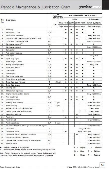

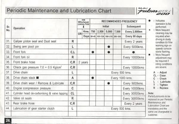

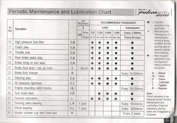

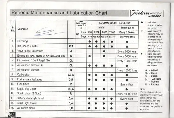

reason why every bike has a manual book to guide the owner for its Periodic Maintenance & Lubrication Chart so that
the owner religiously checked n maintain the bike to last longer
its the same like our own body, we need to check either on our own or visits a clinic or dentist regularly to check our teeth, eye, blood pressure, etc to be in good heatlh
