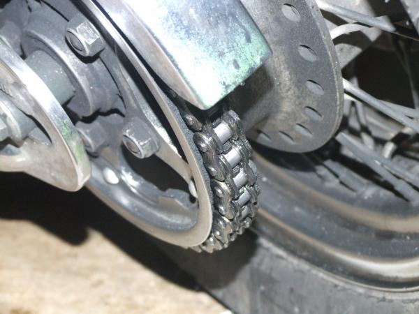

after installing the oiler ..ran the bike..off course the goo in the chain turns into mud..and starts to drip here and there...
then inspiration strikes and yhe scubber beginf its life then..
together with the oiler it works like a charm..the side effect is that the wheels became its victim..hahahha
so now we add diesel to hasten the cleaning time...running th bike stationary..taking precaution by having guards all round the places where we want to keep clean if possible to minimise the throw off on to the bike,
Never argue with an idiot. They'll bring you down to their level and beat you with experience every time:dot:
heres a photo of the wheel...spend less than 2 minutes to clean off the throw off..ater the initial run.
judge for yoursel whether its worth your while to do it.
