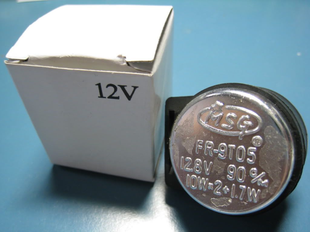

It won't be exactly the same as the diagram. The stock flasher will be replaced with the ones that can support 4x signal lights. I know the Phantom stock flasher is spec'ed for 2x15w signal lights only.
After that, it's just a shunt on the circuit to bypass the signal light switch for hazard light function.

Just to share some of my experience...the relay that LAB sells are rated 2x 10W +1.7W. It will still work even with 4 signal lights but I don't want to risk burning it out.
You can go to this shop opposite SLT, no. 57 Jinda something to get a higher rated relay. Abt $5.50...Costs even lesser than LAB!
I've updated my diy guide for hazard light...if you need help i'm more than willing to share...another tip is to get some female spade connectors and crimp the wires so that it does not come lose over time due to vibration.

The relay I got from them is 4x 15w...
hmm that's interesting, i asked them recently but they only show me this
http://img.photobucket.com/albums/v189/nuttybing/Phantom%20TA200%20DIY/IMG_2011.jpg
maybe my shopping power not enough haha
