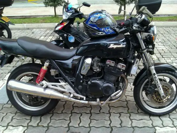

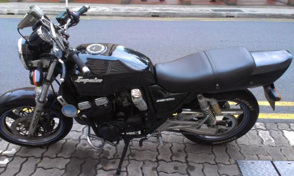

Just reminding myself of what I have done to the bike.
3rd March 2012. Day 1 of ownership.
25th August 2012. 5 months into ownership.
List of things done:
Rear Shocks rebuilt.
Bar End Balancers installed.
Front tires changed.
Sprocket & chain changed.
Seat rewrapped with new cover.
New mirrors.
NoKiss Mudguard added.
Fork seals rebuilt.
Full Service (EO,Coolant,Plugs,Filter,Brake pads)
Stainless Steel Braided Brake Hose installed.
Chrome covers replaced.
Carburettors tuned and balanced.
New Licence plates.
Shift socks.
Customised radiator cover.
IU relocated.
Main Stand installed.
Rear grab rails installed.
Things to be done:
New paint job
Uprated Springs
Derusting of gas tank.
Polishing of Exhaust, Forks
