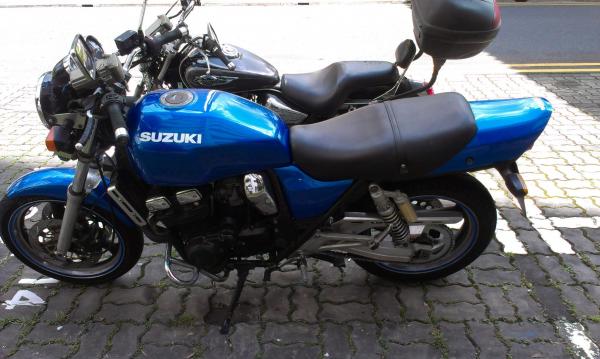

it is done!!!!!!!!!!!!!
the restoration is finally complete. all major work finished!
took me close to a year of on and off doing but it is done. ahhhhhhhhh.

washed and polished it just a couple hours ago. new paintwork with polish = super shine and gleaming.

did new cf fuel cap stickers and rim lining.
wheels now all black. looks SICK!
