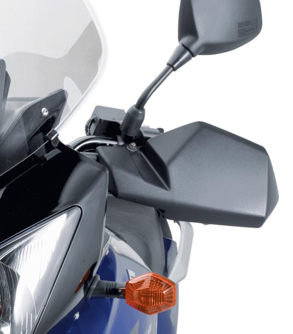

Hi Folks,
Have a brand new pair of Suzuki Hand Guards for Vstrom 650 for sale.
Asking for S$100, cash and carry.
Interested, please PM me, thanks.
