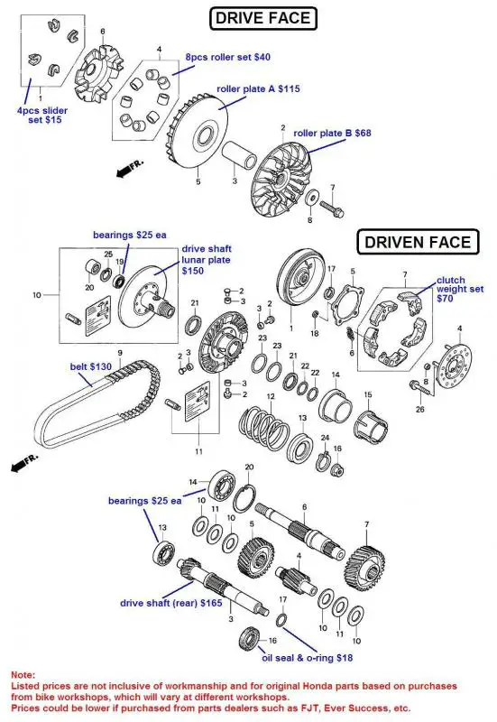

Final drive bearing inside the oil compartment not easy to spoil.
Normally it is the worn out shaft (number 3, bottom of picture) and the spoiled roller bearing inside the clutch housing (number 19 and 20, middle of picture).
See pic provided by Chairman.
Exceptional rubbing/scrapping noise when rotating the clutch housing by hand. Must open up transmission to test.

Gents, What are the symptoms for final drive bearing worn?
How many bearing are in there?
add on to david's reply...
put bike on main stand and let it run at idle (better if bike is already warmed up and rear drive is lubricated instead of "morning dry").
... listen to the noises coming from rear axle (clutch area)
... if bearings or shaft gears are worn, you'll hear some "garak garak" sound; be sure to differentiate between the sounds from belt/clutch from this unique sound
... turn the wheel in reverse direction and observe if "garak garak" sound becomes worse. if yes, very likely something inside is loose and we'ld recommend that you send bike for servicing.
cost of repair depends on what is changed inside... some of us spent around $500+, see our post at
Normal Gear Oil For Final Transmission? Not Recommended!
:goodluck:
