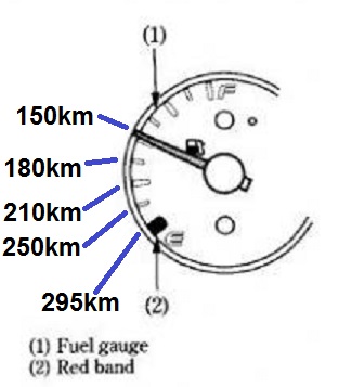

Guys Wat mileage do U get for full tank..my started blinking around 210km..wen blinking stops..means empty? Or stil can go? N how to stop e splash back during refueling?
basically, blinking means go into reserve (SW has about 4 litres). you will definitely know when tank is empty, no alarm no signal and also no more movement 动静 at the engine liow :lol:

What bike u riding? It is either your wrist very powderful or u mod till 1200cc. :p
Blinking starts at 12 litres. After that, the balance is 4 litres.
If yours blink at 210km... therefore = 210km/12L = 17.5km/l?
Most SW would be around 24km/l +/-.

mine too getting around that mileage 210 will touch the red zone of the fuel guage . guess due to my job nature travel to about 8 different location per day . encounter alot of stop and go traffic . since i get my bike last month my 24km/l only last me when just refuel after travel about 30km the average display on my bike meter already drop to 19km/l .i every 2 days need to refuel .
Average 90-100km/h, mostly on Expressways (Sengkang to Jurong).
My Old Silverwing data:
1st Bar (goes off) - 95km
2nd Bar - 125km
3rd Bar - 155km
4th Bar - 195km
5th Bar - 225km
6th bar - 255km
7th Bar - 295km
My SW-T:
What can affect FC?
1. Tire pressure.
2. Pillion.
3. Throttle bodies (FI) not Synchronised.
4. Friction on moving parts.
5. Chiongster (wrist too strong), i.e. fast acceleration.
6. Heavy traffic (move & stop).
7. Bike characteristics... example, Jap model old Silvering (with low speed booster button) generally have poor FC that's below 20km/l.
