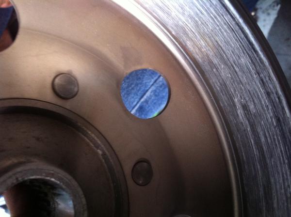

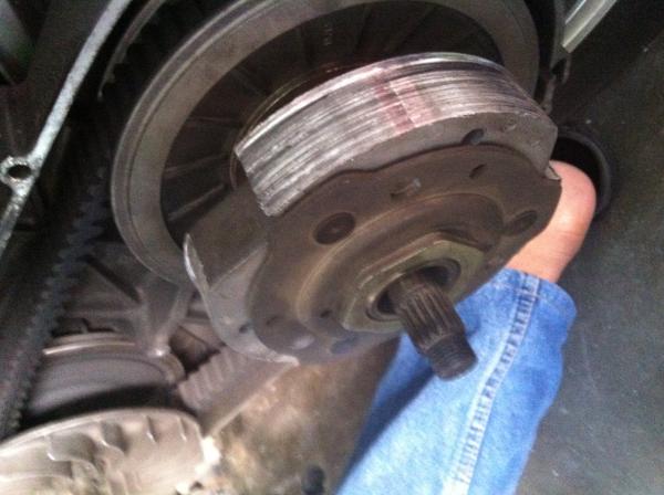

above is my clutch and clutch housing which i took out myself and changing it tommorrow..
bro, wat is yr symptom when you know of this problem and your price is from which shop?
the systoms are jerky when low speed,pick up too to slow(cause clutch is sliping),when pick up u can hear screeching sound..total i do it myself..i spend the clutch $145(stock clutch),clutch housing i send for lay ($10)..and u are ready to go..just tested it..clock 170km/hr..0-160 very fast..thinking of installing j costa variator..

Funny, same thing happen to me Sunday while replacing belt and rollers saw that clutch was metal to metal. Note that they were no symptoms if you reach bare metal. Since it was Sunday, i had to close everything wait for today buy clutch open everything and replace. Fortunately, no damage on the housing just replace the clutch. For those planning to let shop do it, buy the clutch first and replace it together with belt and rollers can save you some cash.
also, this is my first clutch replace from new. Mileage almost 30k. Mix of city and freeway and mostly riding alone weighing at 90kg. Also depend on your riding style.
