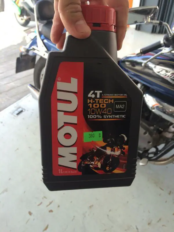

So, today I found nice shop in Phuket with motul oils
Chose Motul hi tech 100 10w40 full synthetic, will see how it will goes)
reccomended oil is between the ranges of 10w40 - 20w50
Change oil for Motul H-tech 100 MA2 10w40
first 100km passed and my impressions so great, vibrions and noise decreases, and also vibrations after 90kmh goes.
engine get deeper sound and power increase little bit) costs 10$ 1L
