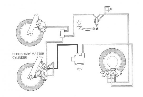

Ans 1) Bro if i not wrong, yr 02 model dun hv CBS, only ABS nia. If i not wrong ABS-CBS came on 06 model onwards. Anyway CBS is controlled by the ECU on 60% frt/40%rear. If u brake more on rear, ECU will cut in the remaining % @ frt.
Have to correct you here. The Combined Braking System (CBS) is not controlled by the ECU. It is controlled by a system of hydraulic hoses and brake pumps and a proportioning valve. There is a secondary brake pump on the left front caliper that activates one circuit to one piston of the rear caliper when the front brake lever is applied. See the schematic attached.
