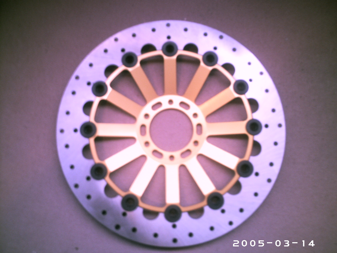

CBR Brembo type semifloatin discs 300 NETT per set..cheaper then std!For road and race as in Performance Bikes.I import these discs and they are not used ones..PM to order ready stock..
